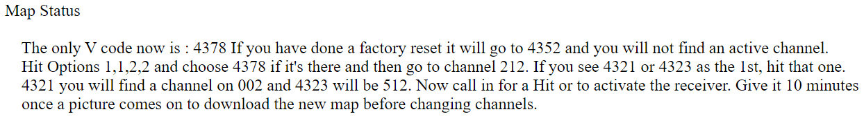

Weird.....if I click the link in my post above I get a "404" error. But if I Google "Shaw Direct Channel Map Download", I can see the document. Maybe it's an archived page. I snipped the text and attached below.
Also, I'm sending you an e-mail to your Global Address on a related subject.
