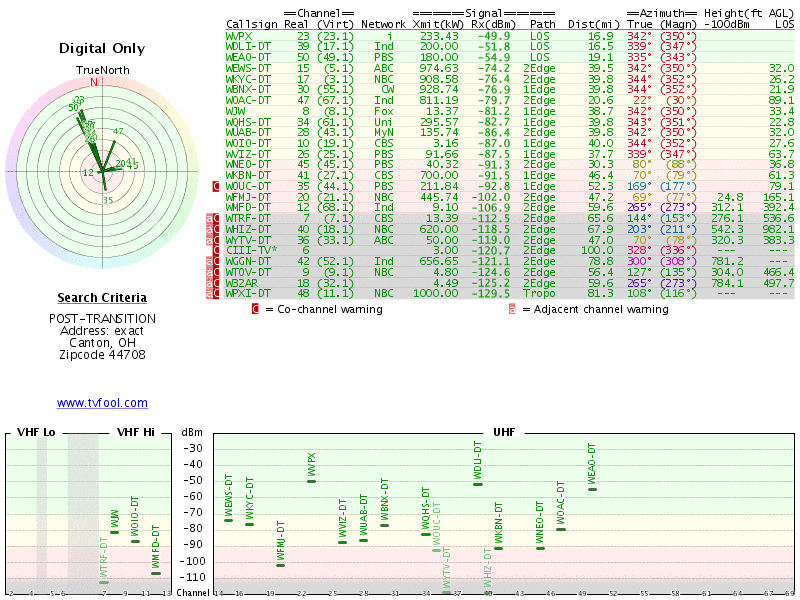

I was hoping for an antenna recommendation to service my elderly parents home.
I picked up a couple Zenith DT900 digital converter boxes and set top rabbit ears only pick up 2 stations and none of the big 4 networks. If possible I would prefer to do an attic mount in the crawlspace of their single story ranch as they are opposed to an outside antenna. There are 3 different televisions that need a hookup to the antenna.
I'm reasonably geeky in that I've built my own Mythtv system and made a DB2 clone for my own use but I've never done an install with multiple ~100ft cable runs to separate televisions so I'm unclear on amp/preamp choices and it seems like I would also need something like a distribution amp to service 3 tvs.
I've attached tvfool data for the location. My intention is to take my homemade DB2 up into their crawlspace as a test run to see if I can get anything at all. Initially it seems like a CM4228 might be a good candidate as most of the stations are in the same general direction and there are 2 must have(Fox8/CBS10) VHF Hi stations.
I'd appreciate any experienced advice.

Every dB is precious. An antenna with good gain outside, using RG6, will help a lot. A preamp, such as the channel master 7777, at the antenna, will preserve the S/N ratio through splitting. I suggest a 15 dB gain VHF(hi)/UHF antenna placed high and outside with a channelmaster 7777 preamp for your case. If you want everything you can get, add a 10 dB distribution/line amp at the splitter (better: 5-10 dB variable gain here.) If 15 dB means too big an antenna at Ch 8 and 10, 8 dB gain would make it, but not by much.
Ideally use a VHF-Hi and separate CM-4228 for VHF and UHF, with the 4228 at the top.
A CM4228 sounds like a reasonable antenna to try, EXCELLENT at UHF, but might be insufficient on Ch 8-10 for you. A 16 dB S/N ratio is required for reliable ATSC reception, 15 dB S/N is right at the edge. 14 dB, forget it.
Given the receiver sensitivity of -83 dBm, 4-way split of 5-6 dB, coax loss of ~8 dB, you need a minimum signal strength of -83 +6 +8 = -69 dBm at the antenna.
As practical antennas run ~15 dBi gain (12-19dBi depending on antenna), you can subtract that: -69 dBm -15 dB +1 dB (balun loss)= -83 dBm minimum signal on tvfool (I assume tvfool means isotropic dBm=antenna with no gain.)
Now add 3dB for *some* margin (rain, airplanes, leaves, wind moving antenna) and you have -80 dBm minimum signal.
As your "must-have" signals are -81 and -87 dBm, they are below -80 dBm, and too low for reliable reception with just an antenna.
A higher gain (19 dB) antenna is expensive, LARGE and hard to aim (undesired? rotater needed..) but would get you 4 dB more, for -84 dBm.
Skip the larger antenna idea....
A preamp? Channelmaster 7777 2.8dBNF at ~23 dB gain:
Now noise floor comes in. The 2.8 dB number is how much noise the preamp adds compared to a 75 ohm resistor at 290 deg. Kelvin (about 17 deg C). The resistor noise is -95.2 dBm, our reference level. The preamp output noise is equal to -95.2 dBm + 23 dB (gain) +2.8 dB. Converting that to input noise (the resistor and preamp noise are uncorrelated, and it's a complex calculation) yielda a preamp input noise floor of -98.5 dBm.
Your antenna signal must be 17 dB above this noise floor (1 dB loss through balun, 16 dB S/N for digital signals.)
With the antenna gain of 15 dB and a signal of -87 dBm, you have -87 + 15 = -72 dBm at the antenna terminals. -1 dB through the balun, now -73 dBm.
98.5 [-dBm] - 73 dB [-dBm] gives an S/N of 25.5 dB, adequate S/N for solid reception at -87 dBm.
Now, overload: Your strongest signal is at -49.9 dBm (UHF ch 23), add 26 dB (UHF) gain, 15 dB (antenna) -1 dB (balun loss), and you have -9.9 dBm output. The rated max output is 51 dBmV (1 dBmV=-48 dBm) or +2.25 dBm. You're 12 dB under this, so TV channels won't overload you.
I only considered one channel for overload because the others are at least 2 dB lower, and this will result in <1 dB error, insignificant in your case. (I assume the nax output rating is for 1 channel)
But you might get overload at FM or other frequencies. This is best tested with an analog TV for channels present on (actually) empty channels, but could also be noticed if digital quality drops on any channels when the only system change is adding a preamp.
BTW: Your minimum TVFOOL signal on VHF is -97.5 dBm (hairy edge, decoding problems), and minimum reliable is -96.5 dBm), assuming 15 dB antenna gain, 1 dB balun loss, and the C-M 7777 preamp at the antenna.
Note that with a 0.5 dB NF preamp, 0.5 dB balun loss and 17 dB antenna gain, the noise floor for digital signals on tvfool is -106 dBm. This is hard and expensive. From here, only cryogenic cooling and BIG antennas will help.
Hope this helps!
