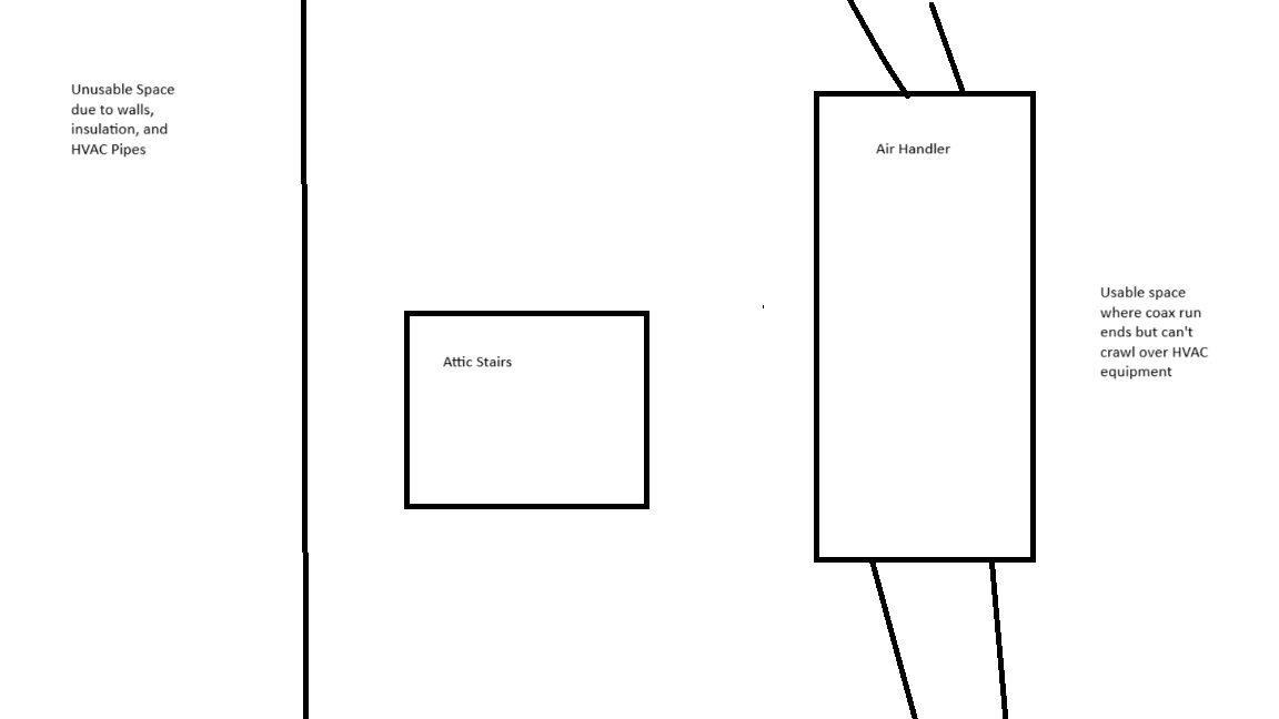

I'm currently in the process of building a new home at the moment. When the sheetrock hadn't been put up, I had the electrical guy run RG-6 to the attic space at the far end of the garage. Now, the area in the attic where the coax runs were placed has a big air handler in the way. The house is on a slab, so the HVAC equipment is all in the attic space. I can't crawl over the equipment to place the antenna in the small area at the far end of the garage. I'm wondering if I can attach one to the rafters above the stairs. I'm thinking about having the electrical guy relocate the coax runs to the top of the attic over the stairs and have the antenna mounted to the top most rafters over the stairs. I've attached a top down view of the attic space from over the garage as reference. There's not much room for storage outside of the HVAC equipment. The only usable space is over the garage since the part over the house will have insulation blown in around the maze of HVAC piping. I'm thinking I can maybe get a medium sized antenna mounted directly above the steps, but I'm fearful that the motor in the air handler will cause a lot of electrical noise to the point that my signal quality won't be great. I have 2 channels in the VHF band in my area that likely won't be receivable when the A/C or heat is running, but I'm wondering about channels in the lower UHF band. One time I can recall that I had an indoor antenna placed near a motorized filter that caused low UHF frequencies to glitch out, but those higher (channels 25 and above) had no problem with reception. Thanks for your time looking at my post and for your advice.

It all depends on available signal strength in your location and other factors, but I'll just say this:
I had an antenna in the attic once. Never again. Route that cable outside and mount an antenna on the roof or other suitable location.
I have a great signal location for my main OTA market, and I can sometimes pick up the next nearest market when tropo or night time ducting occurs with an outdoor set up at my old house. I'm trying to avoid an outdoor mount due to the fact that my house is the first home in the neighborhood. My builder is trying to make it look ritzy due to its prime location, and I don't want to detract from the exterior look of the home. Believe me, if I didn't have all eyes on my home, I'd love to put it outside, but that's not doable. My only other solution is just to get some good indoor antennas for every TV room, but since I've gone to so much trouble for an attic install, I don't want to discount it completely.

I pondered over your description. Because of efficiency requirements mandated on newer HVAC equipment I would guess the blower is a PWM type. So a switched lead on the controller board will tell the motor to change speeds and the motor will have its own integrated module. The air handler is a big grounded metal can and 'should' contain most RFI. But, who knows. Straight a/c with heat strips, or heat pump? Is the condensing unit compressor an inverter type?
Lot's of factors here. If you're in it for the long haul and an attic antenna is the only option. What's to say you couldn't build a Faraday cage with double layer window screening and its own dedicated earth ground to encase the air handler unit. But make it serviceable for the poor tech who will sweat his cay-jonnies off up there in the summer.

Run a signal reception report on your EXACT home address or Google Map coordinates at the link I'm giving you, and post the RESULTS link in this thread. Then we can advise you without just GUESSING. Attic can be fine in some cases, BUT, 'what antenna and where to locate it', is always a guess without a reception report to at least give you a good idea what you are dealing with at your location: https://www.rabbitears.info/searchmap.php
Otherwise you might spend a lot of time and money trying antenna after antenna, and location after location until it works "good enough", if ever...

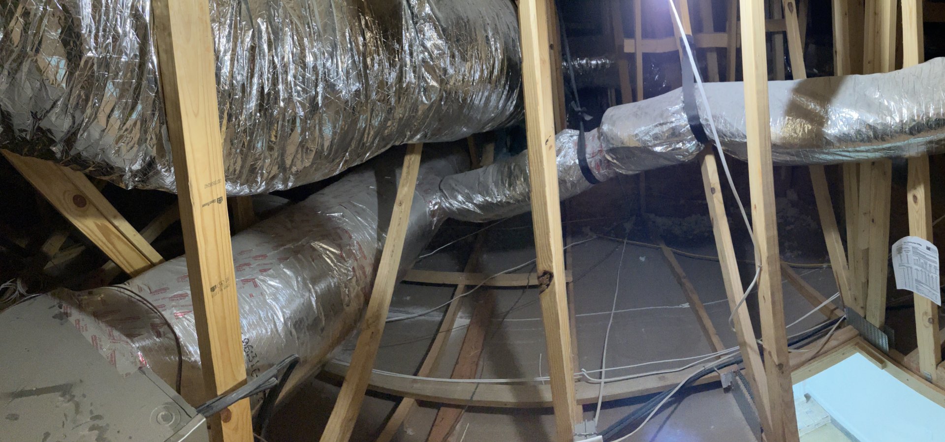

I tried to put in a full panoramic photo of the attic area, but the site said that was too big. Anyway, I opted for the Televes Dat Boss Mix LR Full band antenna. I did some measurements in the space shown, and I can just squeeze in the antenna without disturbing the duct work. It's a bit of a no man's land with no flooring, so I'd probably have to sit on those thin pieces of wood while assembling the whole thing, but it's the only usable space I have without having to crawl under all of the duct work.
