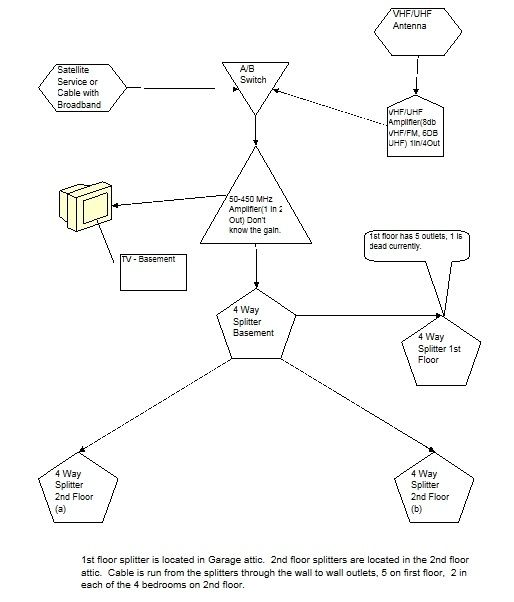

I would like to use existing cable to distribute Satellite, Cable TV, Broadband Internet (cable provider), and OTA Antenna signal. My
objectives are to have Satellite and/or Cable and OTA TV/FM available at all my pre-wired outlets.
What do I have to do to accomplish this?
I have posted a crude diagram of my homes cabling and a narrative which may be of help.
