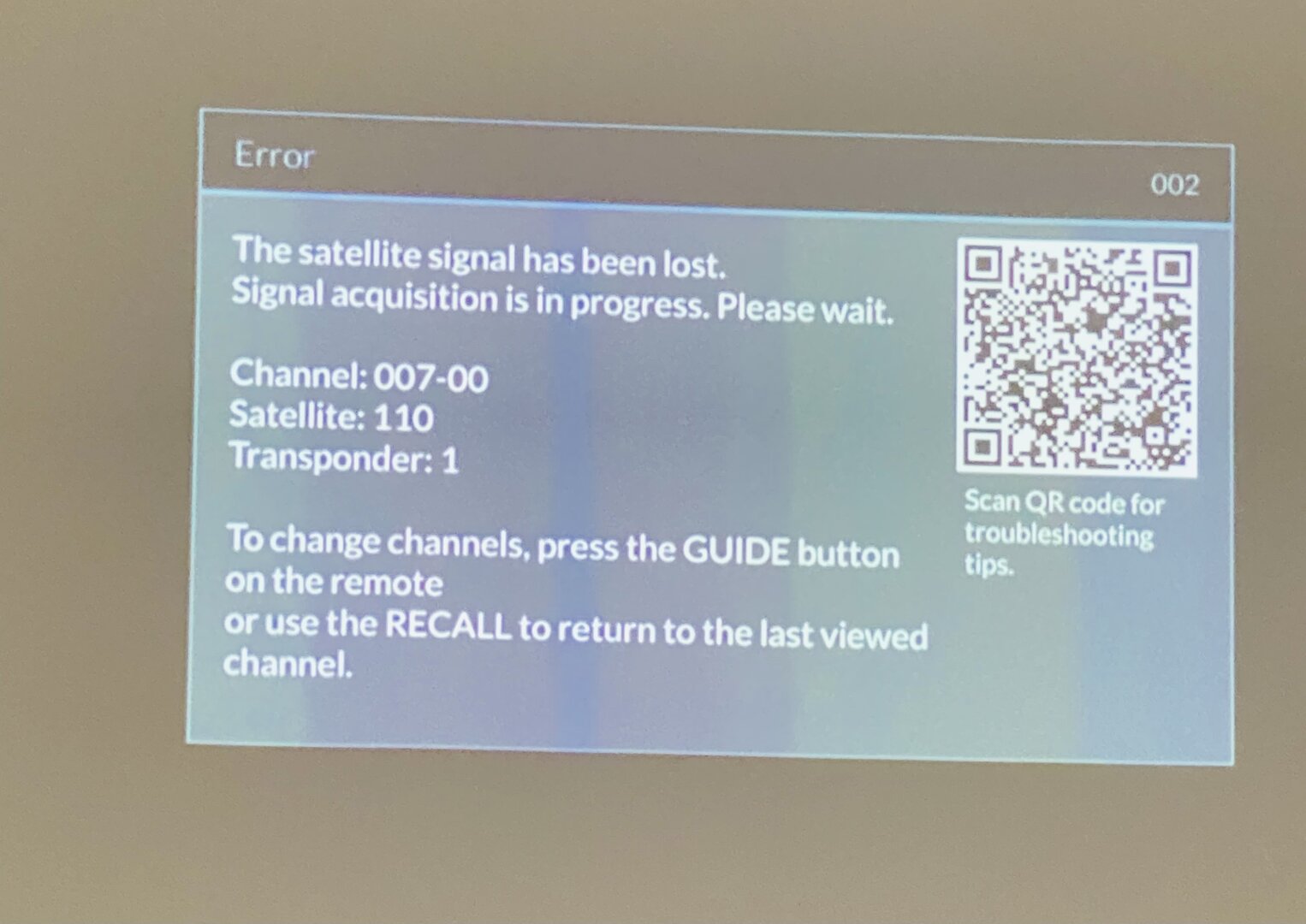

Not sure what you mean when you ask which channels. attached is the error message I received when I try to change channels to one that isn't working. where do I find the sat numbers and signal strength?

You can get to the diagnostic menu by pressing Home 3 times on your 54 remote. A question for you, are you able to tune to channel 2, your local CBS station? That channel is on the same satellite and transponder as your ABC station on channel 7.
