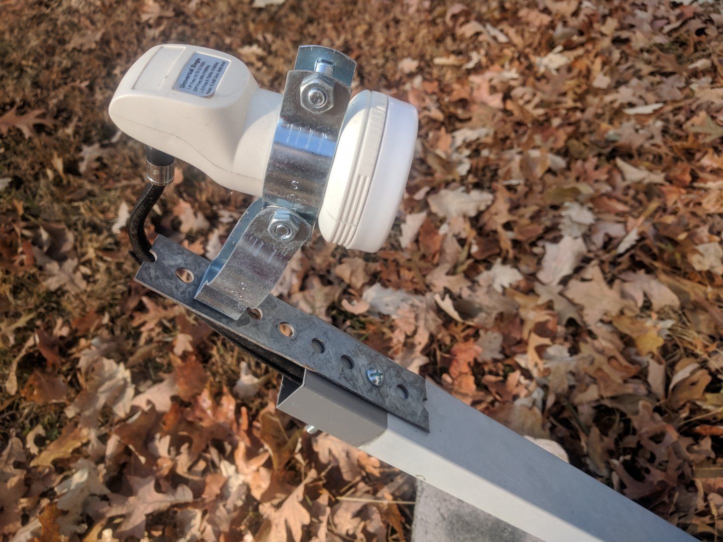

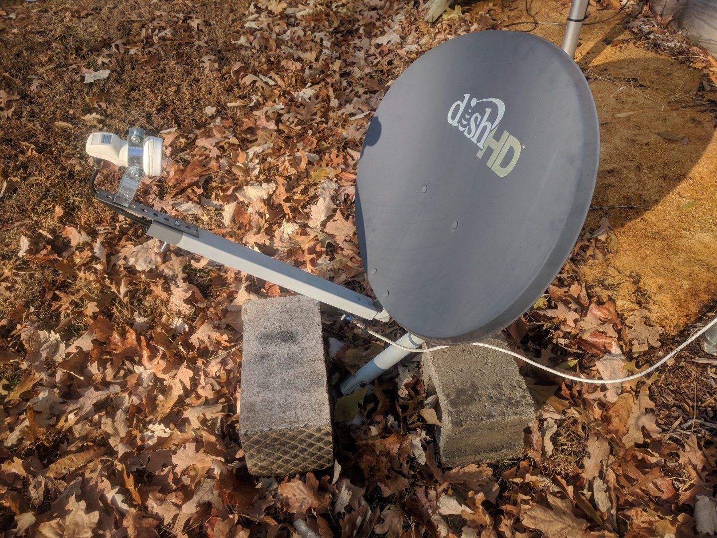

Here's one I'm using currently, probably similar to what you picked up. I also got it free from a neighbor that knows I'm into "crazy satellite stuff." Note the extension I had to fabricate to move the lnb away, it's just a piece of flat bar scrap bolted to the stock arm.
I'm not sure the jury is in yet, but many suspect that the multi-slot DBS dishes aren't true paraboloids and as such, can't be compared by overall sail area to dishes that have a unique focal point.
According to Titanium's detailed run-down on the Orby TV professional installation, the Orby TV dish is 18x27. The DISH dishes are perhaps multifocal and are the same sail area or smaller than the Orby TV dish.

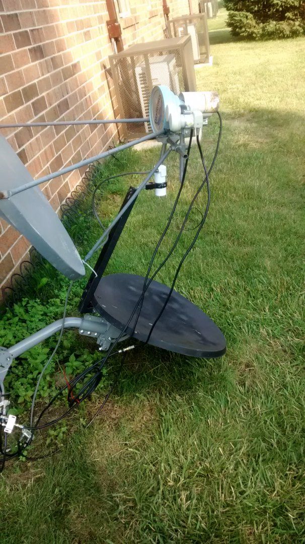

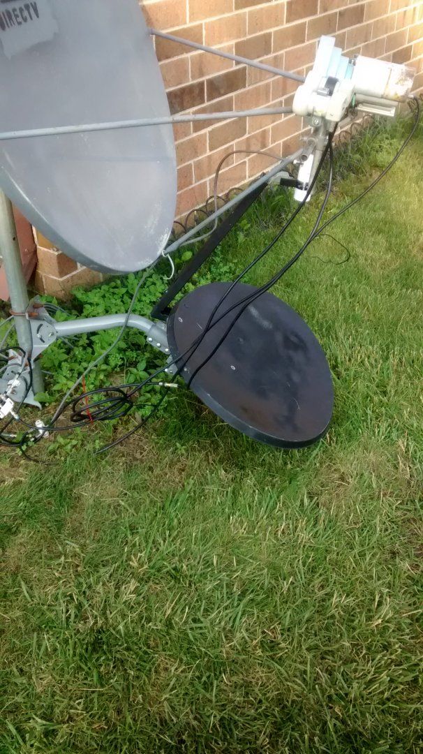

The Turbo HD and the DTV pizza pan dish were the first modified ones i tinkered with. The Turbo HD could actually pull in 87w really well. Had to extend the lnb arm a bit. With DTV pizza pan i could pull in 97w really good and 91w but not all tps. Good fun and takes a bit of time to do but helped me learn alot.

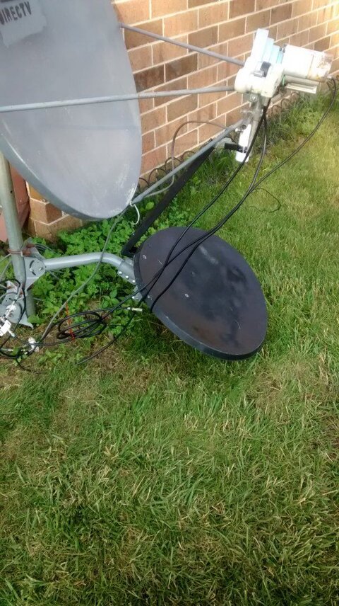

Here is what I did to a turbo hd dish. Look for something better I say I was at 97w ku.
mine still has a plastic fitting at the end of the arm. It has a slightly wider mouth than the metal arm its attached to. Do you know if this should suffice?
Nice work. Plumbers tape and muffler brackets. Looks professional. I think i made mine out of a piece of wood and plumbers tape.
SES-1 and SES-3 on the same dish.
