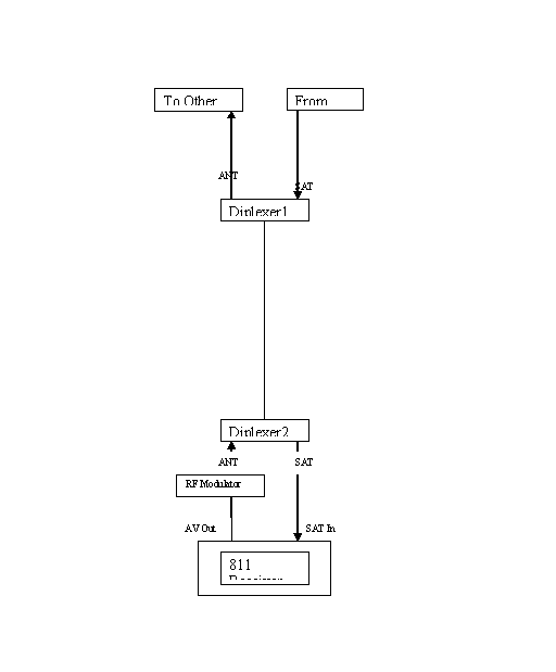

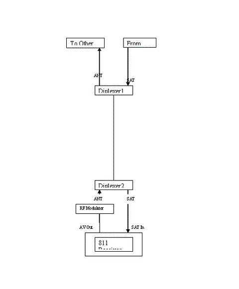

The more I read about this setup, the more interesting it gets. I did searches here found out that the above can be done using 2 diplexers.
I also read about "backfeeding" the output from the 811 back into the line from my Dish, so that I don't have to run a second cable from my 811 back into my basement-just use the existing coax. No one really explained backfeeding. But reading here and there, I gathered it should be like this doc am attaching. Could confirm or deny that this is the right thing to do?
Thanks again.

GaryPen said:
Is there anything currently located on ch. 3 or 4 from the cable feed?
I think there's some channels on both 3 AND 4 in my cable feed. Actually, it's not a big deal getting both Cable and Dish in my bedroom. The doc I provided for the setup for backfeeding-if it works, it'll save me a lot of time and effort. I'll worry about getting Cable and Dish later on when I am more comfortable with these setups.
Better to take a screen cap of your word doc than post them. Word files can contain viruses so people don't like to download them.
I took a chance and looked. Everything is fine except for you mentioned local cable you wanted to include in all of that. You'll want a splitter/combiner where the signal from the 811 comes out of the diplexer to add your modulated channel onto the cable lines.
Mike,
Thanks for your advice and tip regarding word docs. I changed it to a gif now.
I have some local channels on 3 and 4 on my Comcast cable feed. According to Gary, if there's anything that share the Modulated output channel then splitting/combining won't work.
Do you want me to add a splitter/combiner between Diplexer 1 and "To Other" pix?
I really appreciate your help.
-R

I finally got the diplexers I ordered on eBay and I hooked up everything like the picture I posted previously. In addition to that, I used a splitter to combine the signals from Dish receiver and Comcast(in the basement) and sent it to my BR. The Modulator is set to ch 118 in CTV mode. Now, the picture in the BR TV is a bit grainy for all Dish channels. Comcast channels are perfect. If I totally shut off my Comcast cable signal and just send the Dish signal to my BR and use any CTV channels between 64 and 90 in the modulator, the picture is perfect. Anyone have a solution for this?
