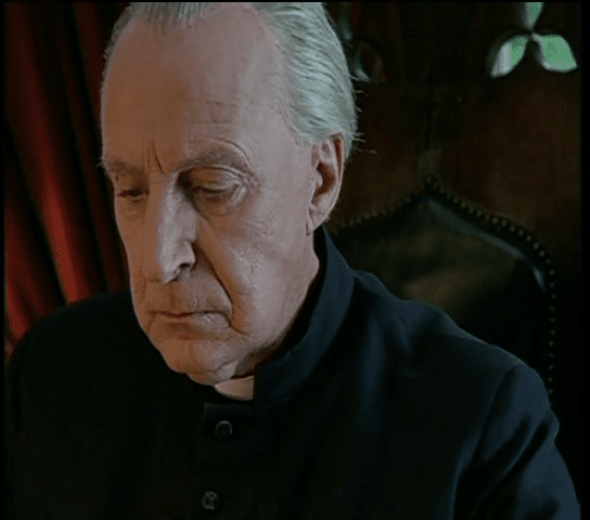

Does anyone else notice what could pass for a convergence problem on dish programs, except that it isn't a convergence problem? It's something in the source material. I see it on almost all of the channels.
It sometimes looks as if the entire chroma channel is shifted to the right, I often notice it on faces. If you look at the sample I attached, you'll see on the left (your left) side of his face, the black of his jacket is shifted over into his face. Mostly I notice in on red.
This is from a Dish 921, do people see it on other receivers?
korsjs said:
can you go into microsoft paint and circle what you want us to look at and then upload it again?
No, but here is the area of interest. It may not be easy to see on a computer screen, but it's a huge defect when viewed on my HT system. If you look at the edge of his face, it looks like razor stubble where it borders the black vest, it's the chroma (or lack therof, in this case) being delayed over into the face. I know about the chroma undersampling, but this seems rather extreme, I wonder if it could be an effect of a bad statmux.
It would be trivial to capture some more examples, but I'm mostly interested in if other people see in on their systems, ie, not a 921. It jumps out at me all the time, usually as colored fringes around peoples faces, but it's visible on many objects.

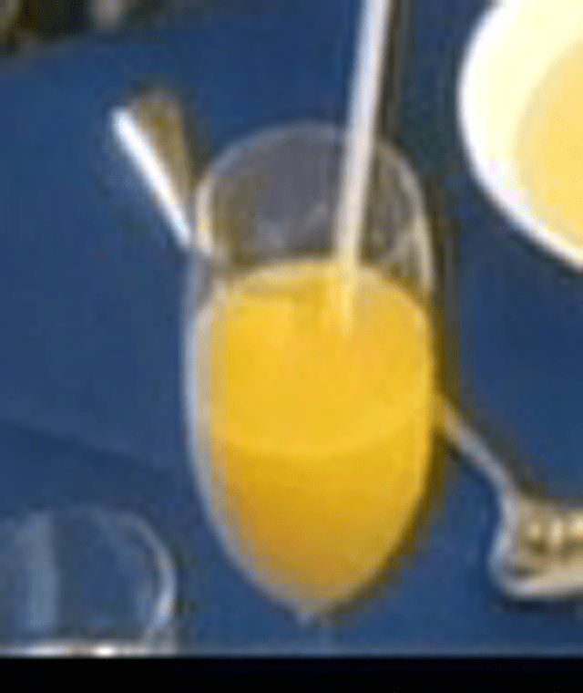

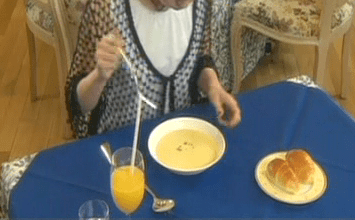

Ditto to all of the above. I also see it on the the title sequences to "Strange" which has a red background with black letters, except the red backgroud gets shifted into letters, and on Night Gallery which has some red frames which the colors don't align with. Most annoying are the ones on the heads tho, and I do occasionally see the effect with blue as well.
Here's a good example. This is about 1/3 of the frame, I trimmed it since it's such a large file.
The orange juice is blue along it's leading edge, and the orange carries over into the tablecloth and also colors the spoon orange for a segment near the glass. If you could simply shift the blob of orange over, it would match up with the orange juice, but you can see it doesn't.
