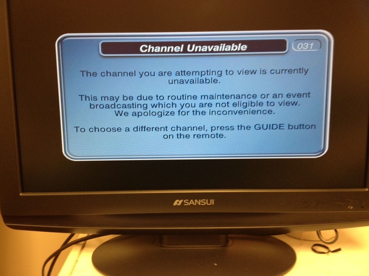

However, RSN FSSWHD appears to cut their feed (or Dish Network does) to make bandwidth available for other programming when channel is not in use. This off air status is shown on the satellite receiver as a message 031 stating "The channel you are attempting to view is currently unavailable. This may be due to routine maintenance or an event broadcasting which you are not eligible to view. We apologize for the inconvenience. To choose a different channel, press the GUIDE button on the remote." I have attached a photo of the screen below.

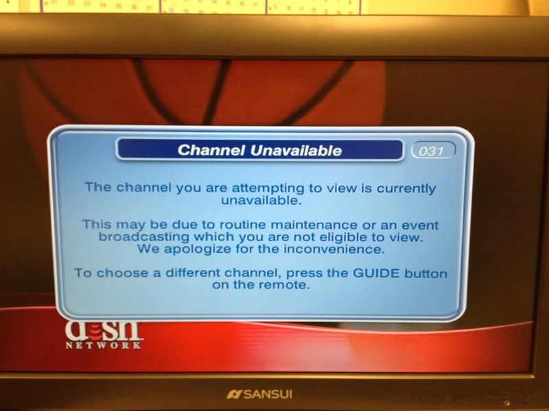

This would appear to be working correctly when programming is not available, however my issue is when the programming returns. The message remains over the programming covering 90% of the screen making the program un-watchable. See image below.

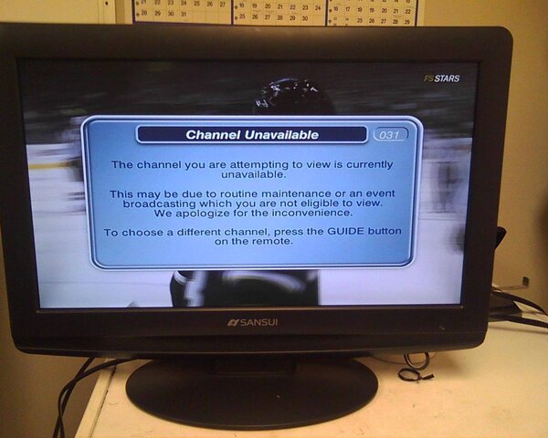

At a residential installation where customer interaction is present you can hit a button such as Guide or Cancel or anything and the message will go away, however with this installation being a SMATV Headend that is not an option as no interaction with the individual receivers takes place outside of service calls. The customers have a feed from the headend channel lineup that they simply tune to their desired channel on their TV and no further control is available to them. When they tune to the inhouse channel for RSN FSSWHD they see these messages and must move to another channel on their TV within the lineup or attempt to only listen to a broadcast they cannot see. As with the picture above you can clearly see the Dallas Stars Hockey team playing a game that is covered by the error message 31.
