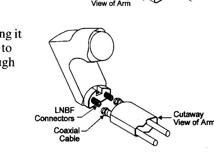

If you have a legacy dual lnb just take off the 500 Y adaptor and put the dual lnb in place of it. connect both cables coming from the receiver and then do the ckeck swith test.

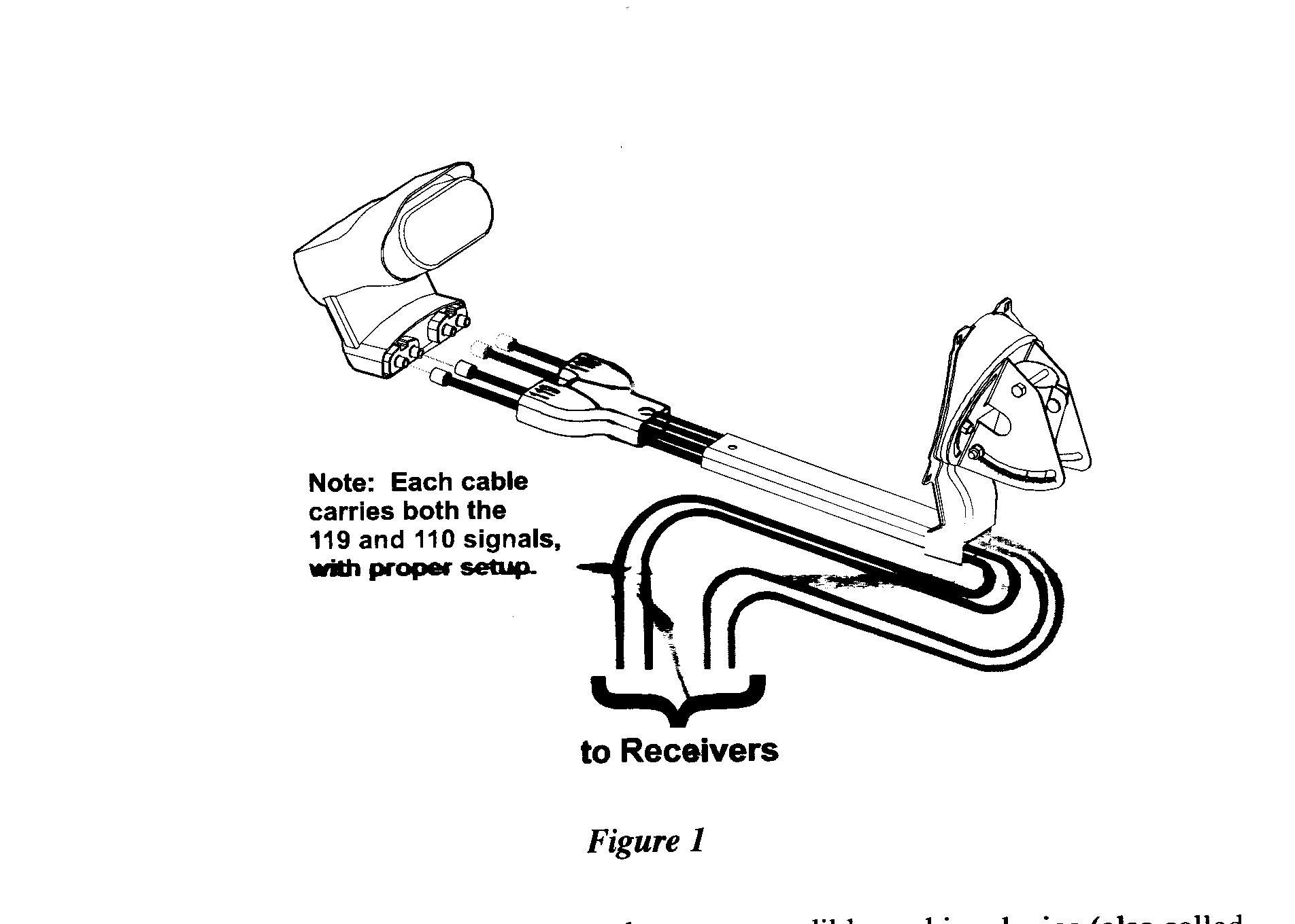

here is a pic two cables from recievers to lnb and quad setup.

If you want all 4 tuners right now to see 119, if you have a DirecTv 3x4 multiswitch that would work.
Run both lines from the 119 LNB to the inputs on the multiswitch and you can hook 4 lines to it and rerun check switch
Yes you will only see 119 but it will get you going to be able to use both receivers
If you only want to use 1 receiver right now, just run both lines from the 119 LNB to the one receiver.
You can use a DirecTV 3x4 multiswitch for one satellite only if its legacy (which the OP says he has since he is using a SW64).
