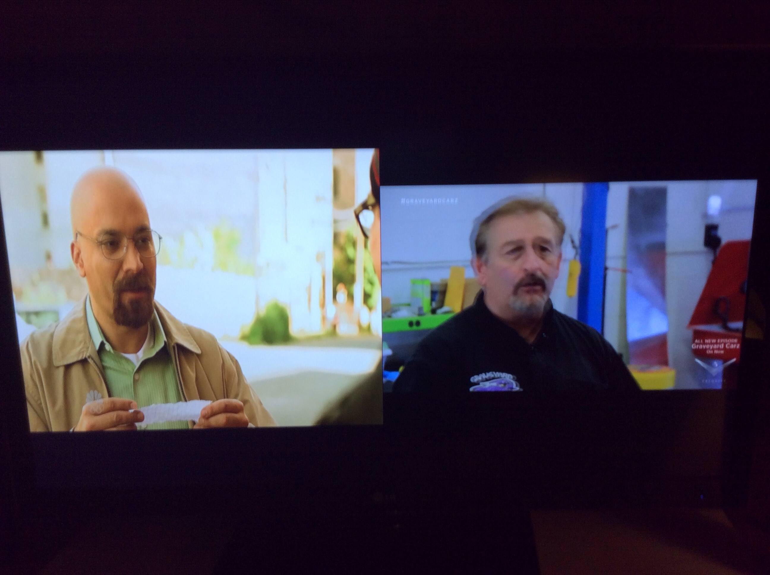

For some reason my picture is narrow on my 722k. I am in single user mode, no settings were changed. As you can see in pip mode one is normal, and the tether is not. The picture remains in hd, but squished. If I press swap then it's all normal. Pressing the format button does nothing at all. If I change to an sd channel it looks fine but again pressing the format button does nothing. Changing the format on my tv also doesn't fix it.
I swap pip and stay in the mode that looks normal but if I'm recording 2 shows at the same time I can't watch the other because of the picture problem.
So how do I fix this and why is it happening? Attached a pic on the bottom. Note that the left pip is supposed to be widescreen but is squished while the right pip is what it should be like.
