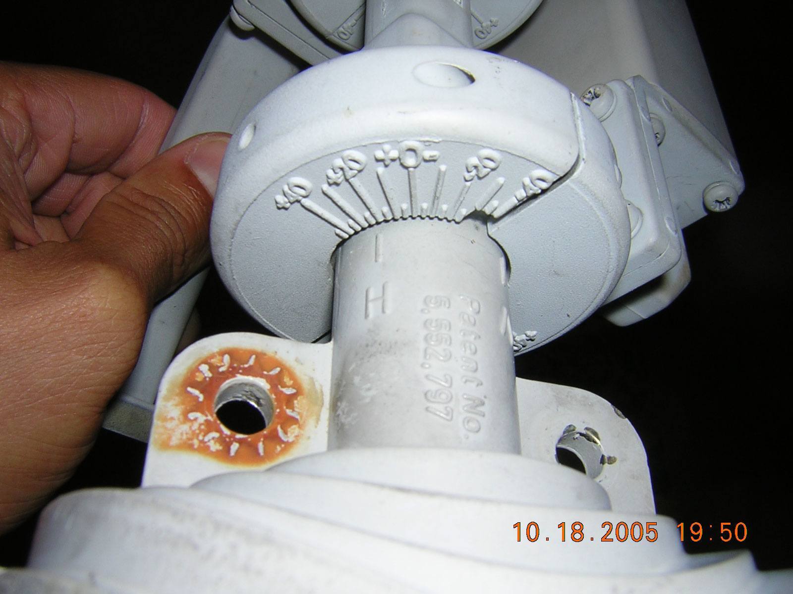

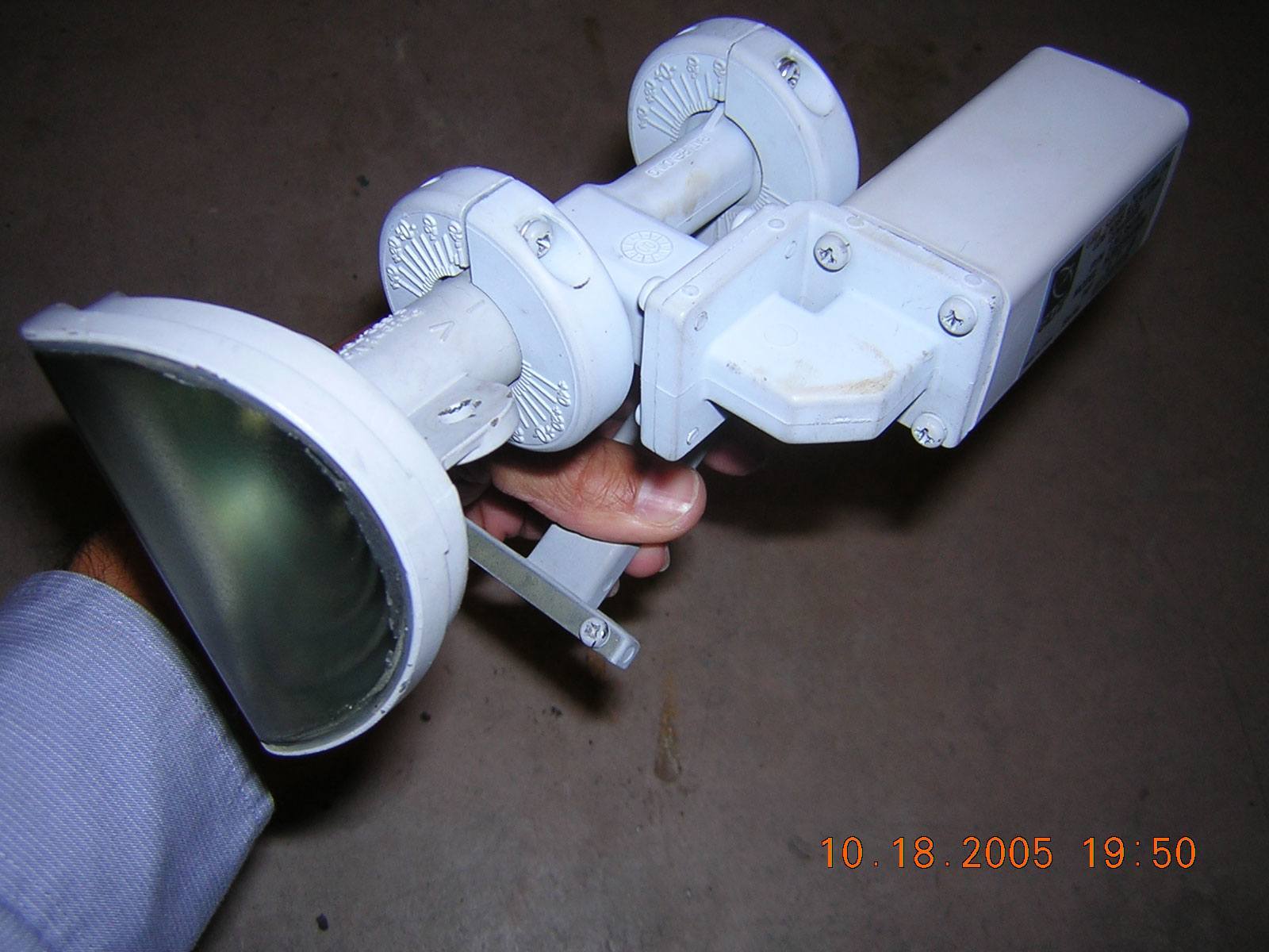

I have a starband KU lnb rec/xmit and have removed the xmit ou. Can I use this with a Winegard 1m to get T5 (FTA)? I am using a channelmaster signal meter to check signal strength. My location is NE US. Any links, suggestions would be great..Thanks
I think the only problem you'll run into is that the polarity on the receive LNB is horizontal and where the xmit LNB was is/was the vertical polarity.
Does this look like your setup?
I ended up with an extra LNB so I took off the notch filter and put another LNB there for the other polarity:
I haven't tried it out yet, but I don't see why it wouldn't work. I planned on using a multi-switch to switch between the H and V polarities.

I'm going to try and include two images. Is it correct to set the H polarity for 26deg? I'm using a Winegard solid 1M that does not skew.
I'm going to try with H polarity for starters..
Thanks
Thanks
The skew setting depends on what sat you want to hit.
Satfinder is a good start for dish pointing / skew information.
If you don't want ot install it, post your zip code and I'll post the results for you if someone doesn't beat me to it :).
