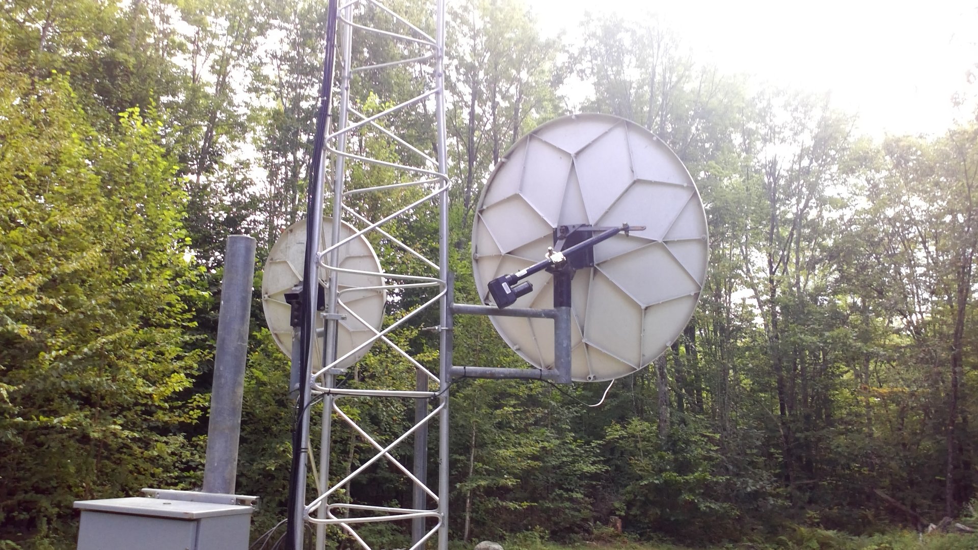

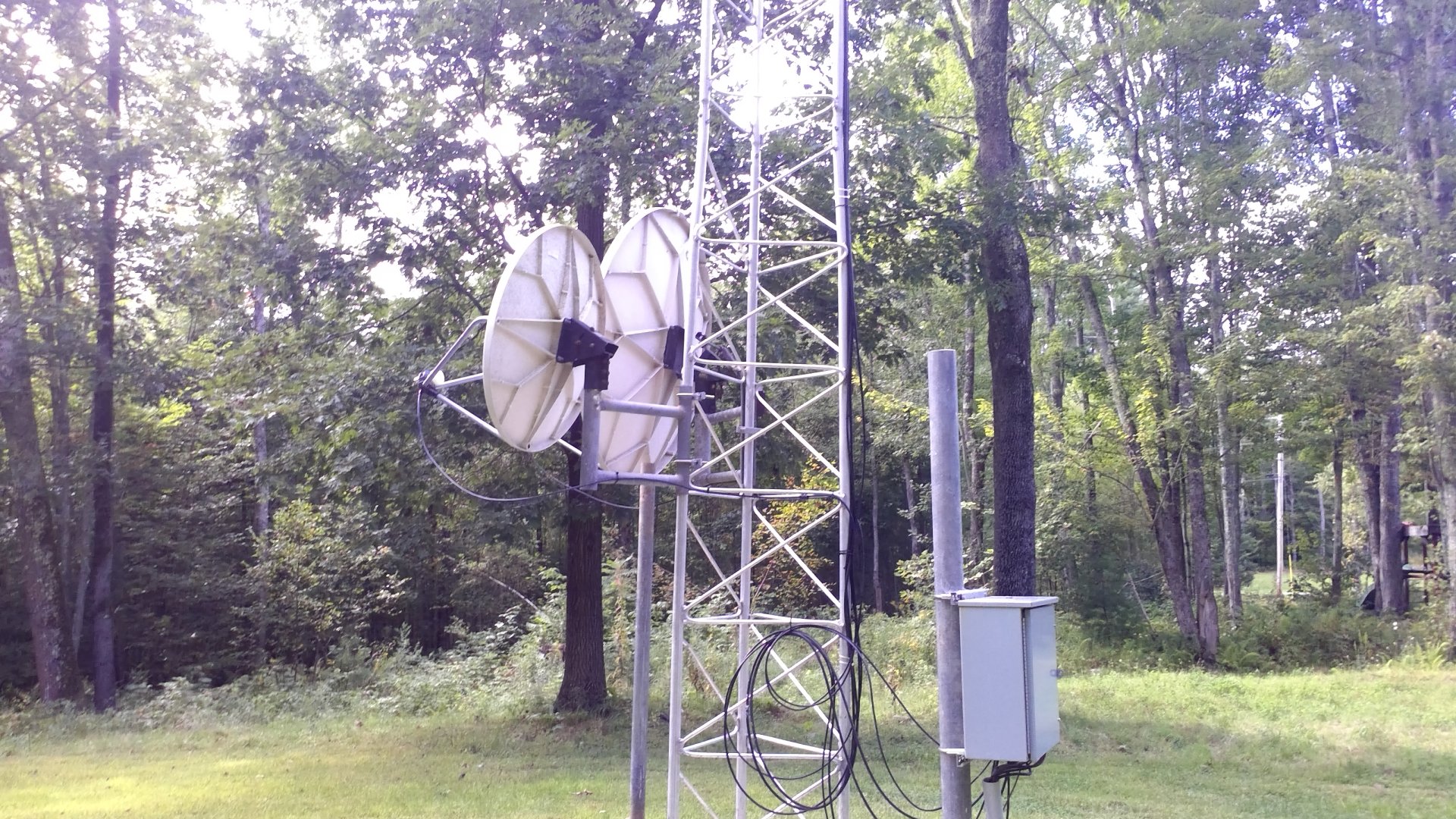

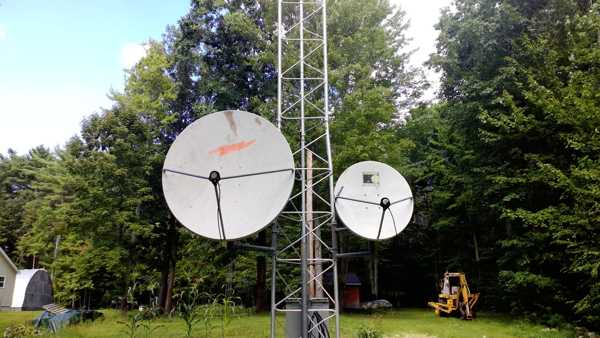

Just wanted to thank KE4EST and Hyper Casey . In the past I've done business with KE4EST, he informed me that he no longer sells equipment and he directed me to Hyper Casey. Hyper Casey was very helpful and got my amigo hd265 going again. I ordered some parts from him and got my dishs going. Currently the smaller dish is on 99* and the 1.2m is on 101*. Thats all I'm interested in at the moment.

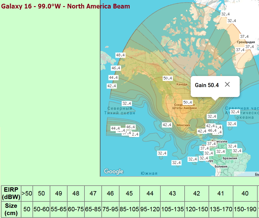

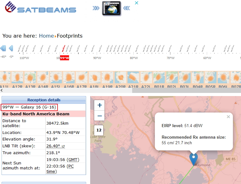

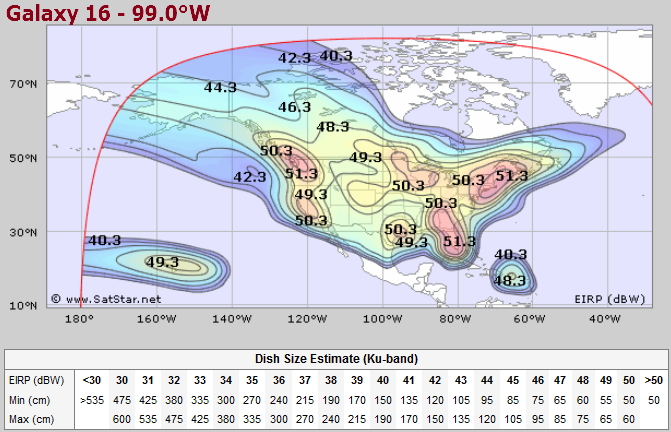

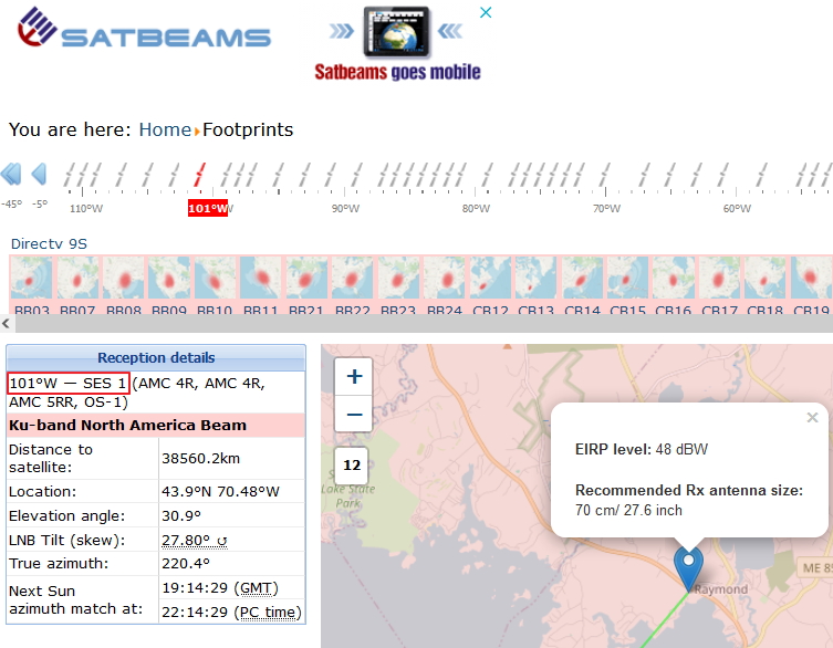

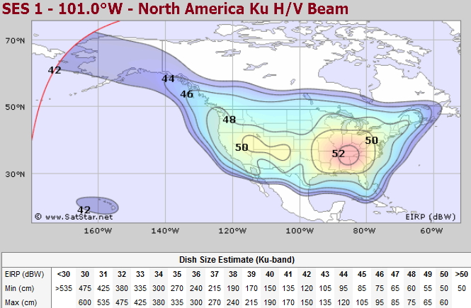

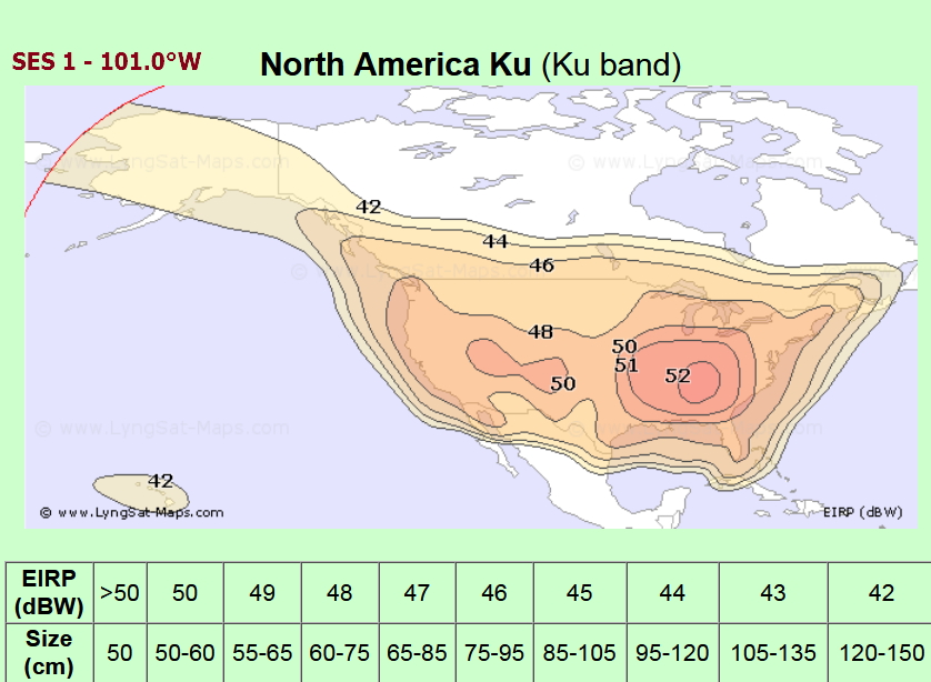

Beautiful and reliable antennas. For the sake of sport, I checked two of your satellites from three sites, coverage maps.
