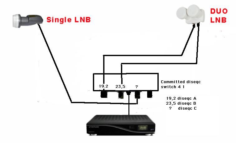

The easiest way to do this, when you have still a free port on your 4/1 diseqc switch:
See the picture in this post: Due diseqc per un solo tuner
You would need a splitter or T-piece though; or solder a "bridge" inside the diseqc switch on the two output ports (the latter is the neater solution). I've had that working for years!
When your monoblock has two ports instead of one, it can also be done as in the picture in this post:
You could also use a diseqc 1.1 switch, or a special diseqc 1.0 OPTION switch. They are more expensive solutions...
Does this help?
Does this help?
