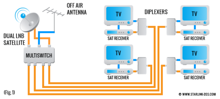

So this handles one LNB. You have other LNBs and a C-band dish almost installed. How will you incorporate additional LNBs to this multi-receiver configuration?
The LNB on the 90cm dish will stay separate. It has its own dedicated line.
Might do the same for C-band, but if a diseqc switch is incorporated, I believe it goes in-line before the 4-way switch.
... but if a diseqc switch is incorporated, I believe it goes in-line before the 4-way switch.
This is how I could do for my C-band and Ku-band dishes. Normally you put a diseqc switch after the motor so the motor current doesn't go through the switch. But in this case, the diseqc switch would be in front of the Ku motor and motor current would flow through the diseqc switch.

I guess this would work:
4 receivers - splitter - Ku motor - diseqcswitch -
Ku LNB(diseqcswitch port 1)
C LNB (diseqcswitch port 2)
The Ku motor will only move when the Master receiver is first used. One must first always use the Master to get the polarization signal correct for the Slave receivers. For blind scans, you first scan on one polarity then scan again on the other polarity switching back and forth between Master and Slaves.
