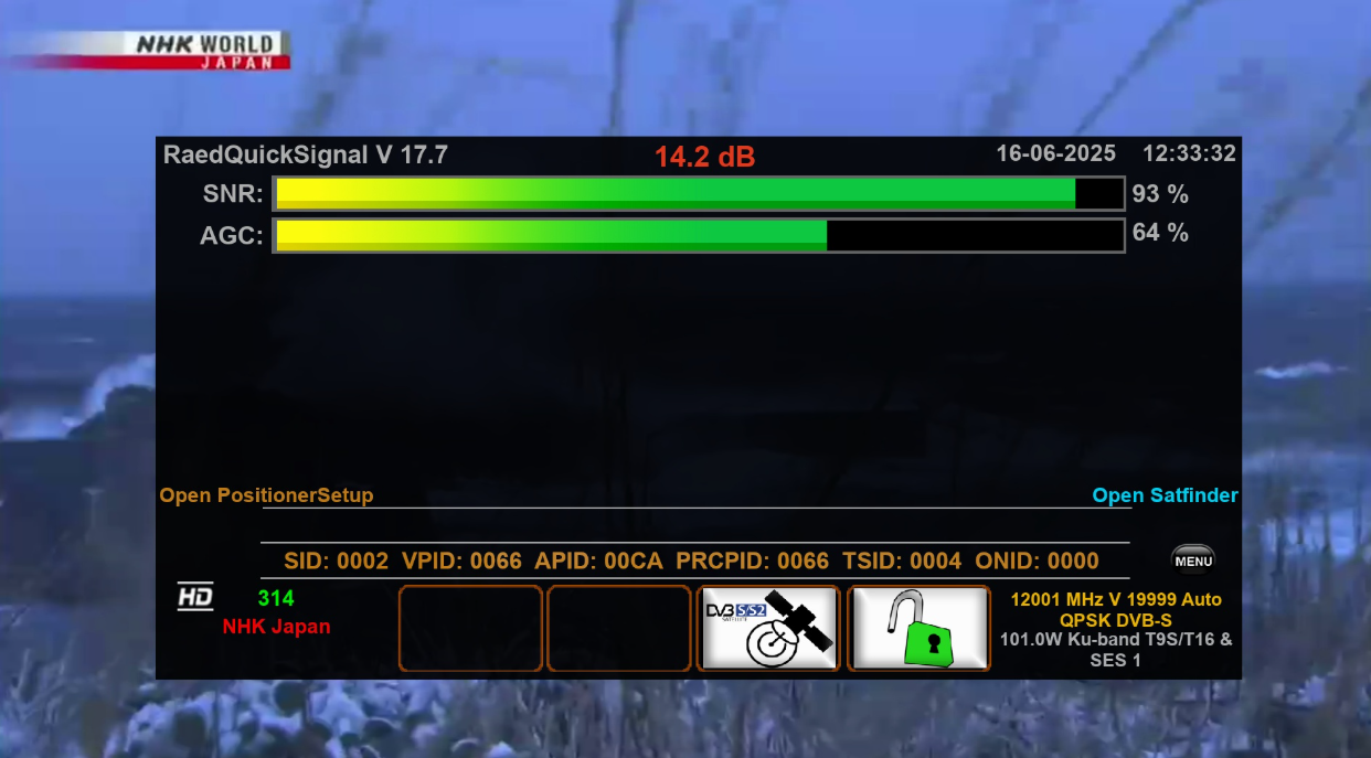

Just stumbled onto this plugin which will be very useful for me while doing dish orientation and using the Edision via wifi as my sat meter to measure signals while at the dish.
The Raed Quick Signal plugin, once installed, allows single key operation. Press 'Text' and the onscreen signal meter appears for the selected channel. Press the right or left key to move to a different channel. Press Exit to end the plugin's operation. Wish I knew about this long ago.

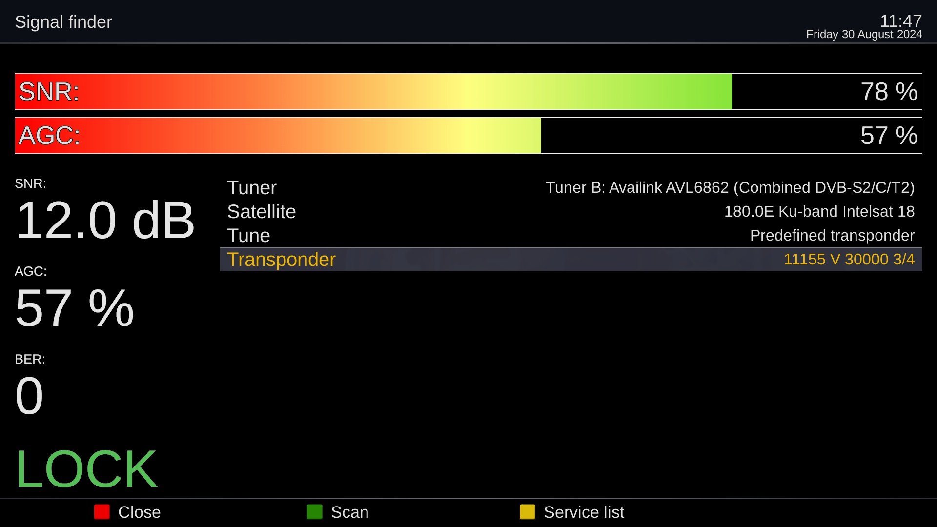

I'm using TNAP 5.1. I usually use the Signal Finder which has a large signal bar (see below) but it requires multiple key taps which is less convenient when at the dish than Raed's tool.

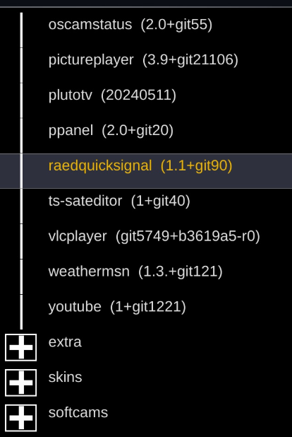

ok I see it now - looks like it's installed by default, i was overthinking it and looking only in the download sections - and on my images it's not listed there
it's also installed by default in TNAP 6

Raed's plugin allows you to see SID/VPID/APID and other IDs right on his display as well as the channel name and tp parameters. Press the Yellow key and jump directly to Positioner Setup to move the dish back and forth to peak. When you exit Positioner Setup, it takes you directly back to Raed's display. Or, you can press the Blue key and jump directly to Signal Finder. When you close Signal Finder, it takes you back to Raed's display again. These actions may or may not be useful in a given situation.
Both the app and Raed's plugin require a channel to be scanned in to be able to use them. If you don't have a scanned in channel yet, then you must use Signal Finder to peak the signal and scan it in.
