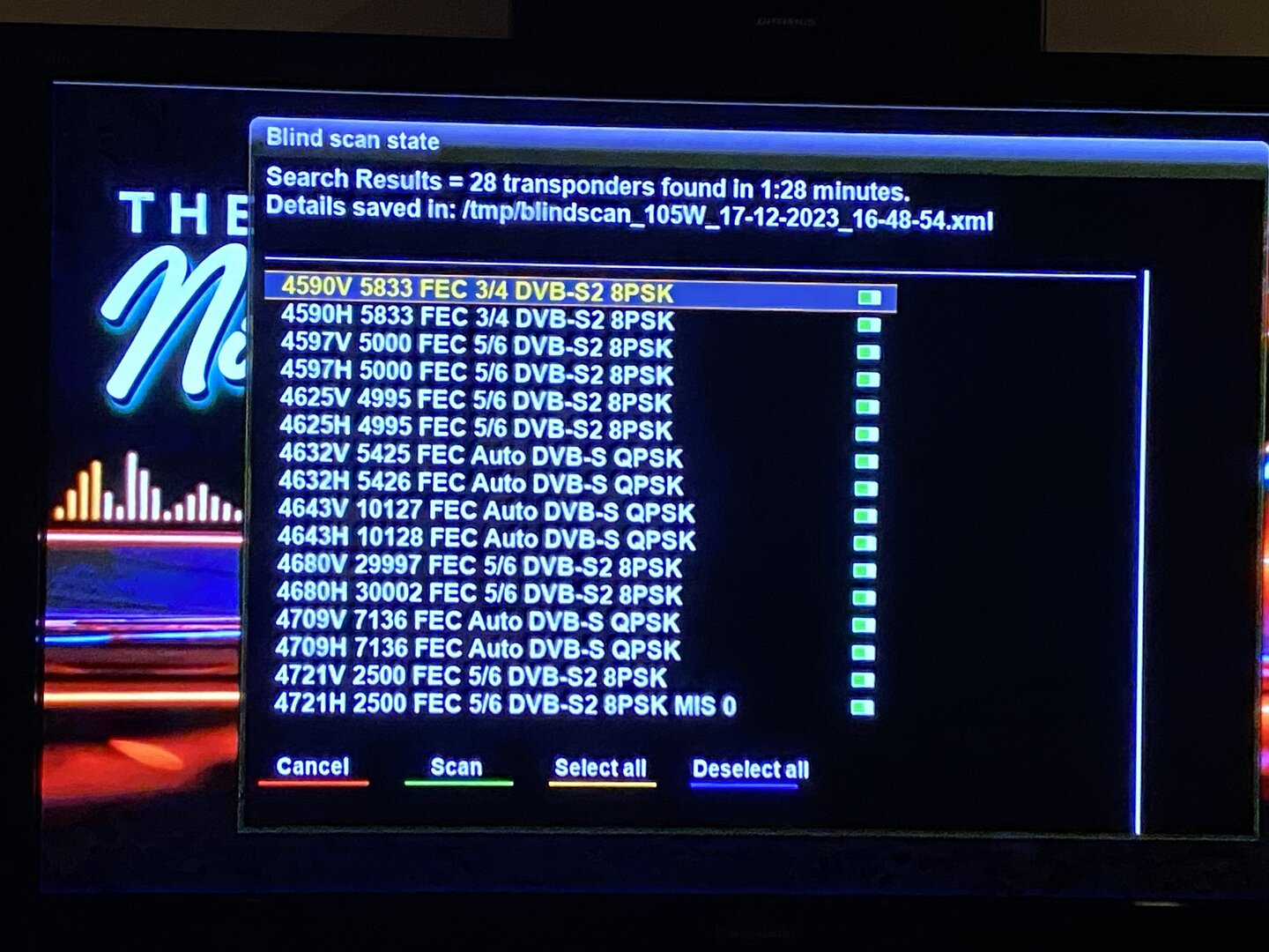

Mike,
I scanned 105w and I got transponder numbers way above the norm.
All the channels are there, but there is no way to differentiate where the channels are.

Those are just the transponders. Now you have to scan them for the channels. Hit the GREEN button
Mike ,
I did that but was scanning in transponders I don't want because I don't know what they carry with these numbers.
As you can also see I also have transponders with matching numbers in both H and V. So I have double the amount of transponders with the same signal.

Check in tuner setup. See if you have the C-band set to 5750, should be 5150

Mike,
Sorry to read about your Covid issue.
I haven't had any vaccines so far this fall, but plan to this coming week. I'm thinking I'll just get the Covid vaccine.
Longhair's suggestion worked.
Somehow it got changed to 5750 from 5150. I still don't have any horizontal transponders and the numbers are still "stacked" but I recognize the frequencies now and can pick and choose what I want.

Long Hair,
Your suggestion brought the numbers to a more recognizable setting, however the numbers are still "stacked" and I have no horizontal transponders scanning in.

First thing to check is under tuner setting. Voltage mode should be set to Polarization. If it is than your lnb power output is probably going bad, only giving you 13v and not switching to 18v for the Horizontals.

Long Hair,
The switch is sending tone and increased voltage to the kU side.
The C Band side has the voltage mode polarized.
John

Have you checked the ku band, to see if your getting both H and V. If your only getting verticals on the ku. I would guess it's a power issue with the reciever.
