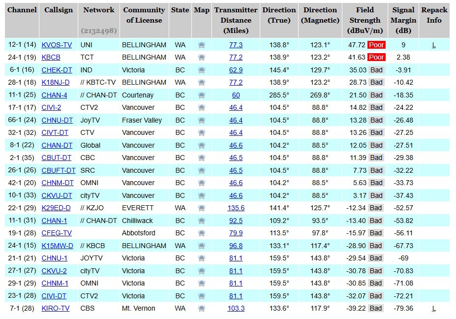

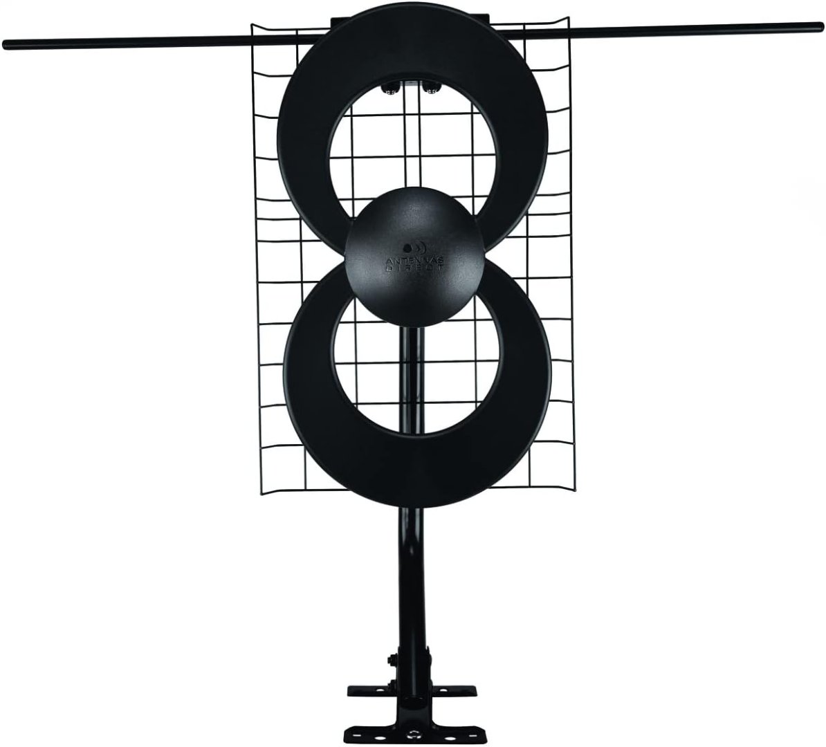

With a 125-foot RG6 run including a 30-dB ChannelMaster preamp and Clearstream 2V antenna mounted 3 feet high, I've just scanned in 15 UHF TV channels including the 9-channel METV mux found on C-band 101W. The transmitters are over 77 miles away as the bird flies according to rabbitears.info and these signals are classed as POOR or Bad.
Yet I'm receiving 23 dB, 15 dB and 18 dB from the three transmitters. The Hauppauge works!
Clearstream 2V:
Rabbitears Chart:
Received are first 3 channels plus all sub-channels.

Maybe you could even get ABC and PBS on clear days without even turning your antenna. They are at 35 dBu/m. I am clearly receiving a station at that level with my antenna on a 3-foot tall tripod for convenience. It makes me wonder if I point the antenna in other directions and perhaps suspend the antenna from an overhead tree, maybe I can find more.

While playing this morning, I happened to toss the cable at the antenna going to the receiver over the back of the antenna to get it out of the way. Everything else was unchanged. 7 dB up in SNR immediately! Back to 23 dB for the METV channels.
I went inside to rescan and sure enough the missing channels were back at their 16 dB level which moments before had BER 255 and, though locked, could not be scanned in. The remaining single Canadian channel was 19 dB. All 15 channels are strong and solidly being received with BER 0.
The cable laying in front of the antenna was interfering significantly with reception. The Clearwater is a good antenna. Now I must turn it in other directions to see if I can find something new. The channels being received are from the top 4 lines of the chart in Post #6. with lowest calculated field strength of 28.73 dBu/m. Maybe I can receive lower.
