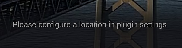

Here's another one I haven't been able to figure out. I think this may have started after loading TNAP 5.1 -- when I press "OK" on the Edision OS Mio+ 4K remote, I now see a message that says I need to "configure a location in plugin settings." I don't recall ever loading plugins, but in the Plugins menu there are certainly quite a few present. I looked through a few and don't see any that are asking for my location.
Thoughts?

yes go to the menu - Plugins - look for "InfoBarWeather" and select that. In there you can enter your nearest city. Note that the country names are spelled in Dutch, and in my case, no matter what US city I select it just displays it as United States (Verenigde Staten). So it seems a bit buggy

Menu > Plugins > Weather MSN
When this weather app opens, enter Menu then enter your Location. Press Save. The error message should go away and you can see your weather for today and the next few days as well as the planets' schedules.

Thanks for the pointers — never would have found this. MSN Weather was disabled, but "InfoBarWeather" was on. Entered my location and that did the trick (Dutch spelling and all).
