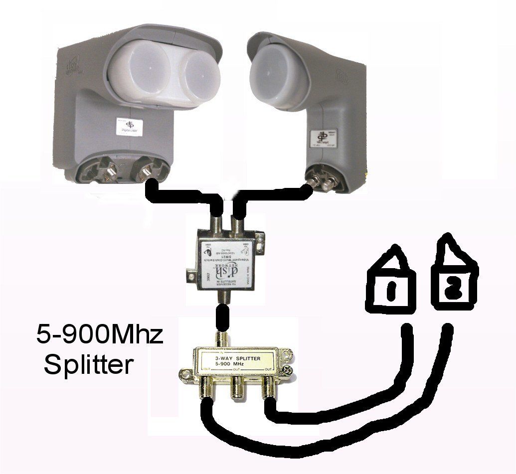

Today I went on my house roof and saw this connections. I don't know does it operate, or may be someone unexperienced connected it in such a way. Please tell your opinion.

hehe theres alot wrong with that setup.
The 900Mhz splitter is meant for cable tv, not satellite. Get rid of that. Next, whats with the two house stick figures? Technically if you're sharing between houses Dish wants you two pay for two accounts.
If you remove that splitter you'll have service on one tv from the 3 satellite locations. If you had a second tv, just duplicate the existing setup. Wire from the twin lnb (on the left), into the SW21.. Wire from the single lnb (on the right), into the sw21. From that sw21 run wire to your second receiver.
Make sure you're using RG-6 coax for your wiring.
That's what happens when cable-minded installers think they can run Dish or when someone who doesn't know better is lazy.
Anole said:
Didn't anyone notice the DishPro LNBs with the SW21 switch? ;)
I saw that, but figured he probably was just copy/pasting pictures from the internet and didnt realize those were DPs. However, it would be a good idea to check whatever he has setup to make sure they ARENT DishPro, considering the rest of the install is a clusterF :)
No. That setup wont ever work. The major flaw is the splitter itself. Have you tried to put a powered coax thru one of those splitters? It shorts the power out, thus driving the receiver HOT possibly burning up the device that supplies the LNB with power to operate. Secondly, DishPro LNBF's with a legacy SW21 switch? That is not the way to switch 2 dishpro heads.
That configuration will not work (that must be why you were on the roof). What you need to do is change the DP Twin to a DPP Twin and get rid of the rest and if this is a ture diagram I would take a picture of this mess and send it to dish and have the correct it for free and let them charge back the idot who put it in.
I know it won't work. I'm just saying why he decided to check until now, that should've never worked. You are right about that splitter, it could kill the receivers and the LNBs.
I think HookieEngineer is right when he said that he just copied/pasted DP LNBs pictures from the Internet. He's probably using Legacy LNBs.

So there is no chance to work in such configuration with a 900Mhz splitter.

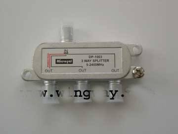

I found picture of an satellite splitter, I see it has DC conductivity(marked with red), what about cheap 99c 5-900mhz
DP-1003 - Three Way Splitter

Here's your "splitter" http://www.microyal.com/dp-splitter.html
I remember these.
Their use was to distribute the same signal from one DP LNB on an 18" dish to several switches for some odd setups.
It was for adding an extra satellite.
You could use a DP Twin, a DP single, and a DP21 switch to get 148 or 61, but what if you wanted to run three receivers?
You needed three LNB outputs for your 61 bird!
This "splitter" provided that . And of course a lower signal level (I don't think it's powered/amplified)
Today, you would use a DP34 and be done with it.
DP34's no longer cost an arm and a leg like they did a few years back!
Yes, they work for their purpose, and only for their original purpose.

But no, TV/Cable splitters have no function in the Dish/BEV world.
And that Microyal splitter isn't generally useful for much of any purpose, either.

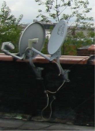

Great dish shot you added above! ;)
I can see from the orientation that you are in the eastern part of the country, and your little dish is pointed at 61.
