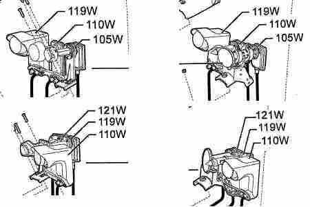

That's the problem right there. You have a 105/110/119 SuperDISH. A 105 SuperDISH has the small LNB on the left and the larger 110/119 LNB on the right. A 121 SuperDISH has the larger 110/119 LNB on the left and the small LNB on the right. You cannot pick up the 121 signal using that setup. Regardless of how it was listed on eBay, it is not a 121 SuperDISH.
Just to be sure, check my attached pic of the four types of SuperDish.
Still, if it is a 105 SD, he CAN get 121 with it - but he'll need a separate Dish 500 to get 110/119.
Edit: :) chaddux and I had the same idea - but he beat me to it. Nice shot of a 121 SD. ;)
I figured it was better to get a picture to make sure we are on the same page since there is probably a language barrier between us. God bless Google Images.
hi, our dish LNB's are identical to the pictures i am going to include(if i can). also, the lnbs do catch 119/110 and 121 but only one at a time. the 119/110 signal does come throu together but only one lnb channels are visible.
we can see the 121 channels but all three lnb's are not lining up all at once.
if you cannot see our included picture, our lnb setup is the same as the one at the upper right picture you posted in your Posts: 2,115 .

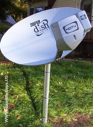

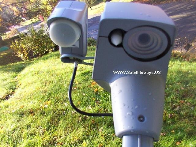

You can only see one orbital location at one time? You can't see 110 and 119 at the same time? If this is that case, your DISH isn't peaked properly. Where are you located?
Also, are you sure it looks EXACTLY like that? That is an HDTV SuperDISH.
yes, its exactly like that, is there a problem with us using HD SD?

The photos you have shown are a 105 superdish.
