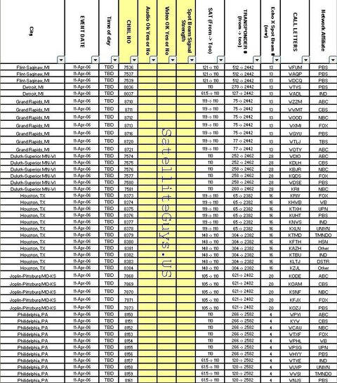

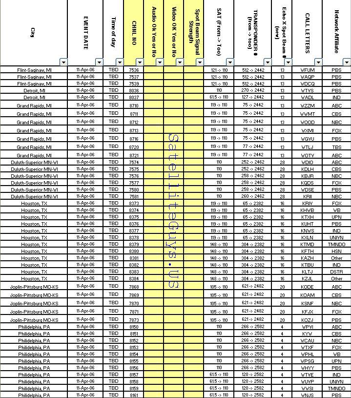

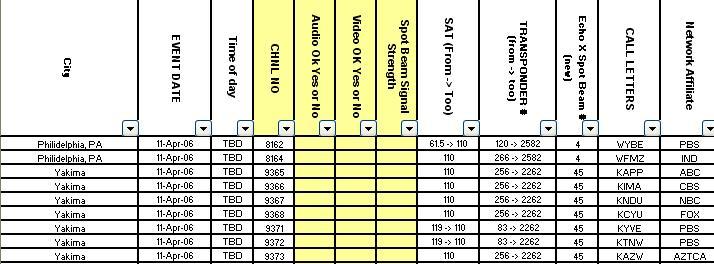

Here is tonight's list of cities which will be moving to the Echostar X Satellite!
If you are in any of these areas in which channels are moving to the Echostar X satellite we invite you (in fact URGE you) to post your 110 signal reading here. Make sure when you include your signal reading to tell us where approxamately where you are, what kind of receiver your taking readings from, possibly a little bit about your setup and finally your transponer signal readings. (Please do not post reading until after your city has moved to Echostar X) :)
I am also attaching the full schedule that was sent to me by a few of my contacts (thank you to them) but I must state, this in NO WAY is an official Echostar document, the listings shown here may or may not be accurate, this document is for reference use only and the data contained may change at anytime.
There now that I got that out of the way...
Here you go enjoy and please lets get those reception reports going!
I do thank all you nite owls who will be providing some very valuable realtime feedback as Dish does their channel shuffling.
  • Echostar_X_Launch_Dates.xls
Hmm, the Echo X spotbeam map must be a bit off if beam 38 is covering Las Vegas and Fresno rather than Las Vegas and Reno.
