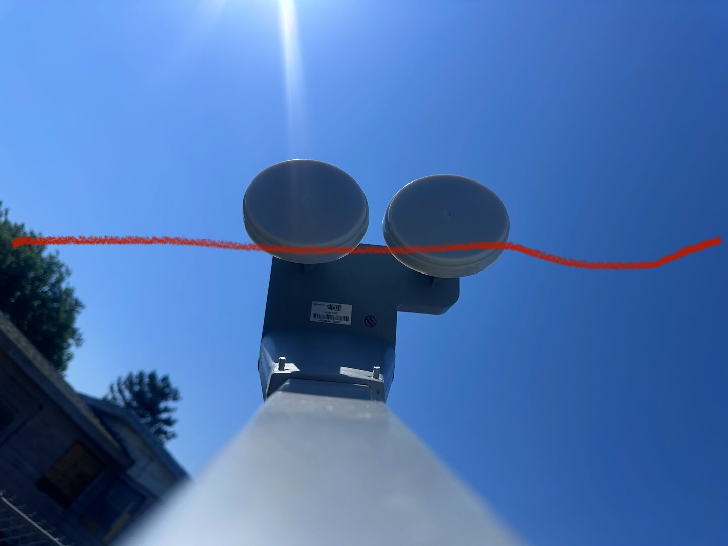

That's fine and obviously it seemed to work for him and is good to locate the satellites to begin with but as far as checking for obstructions it's not as accurate as just putting your camera (or could even do it fro that app) along the arm and getting a view with the lnb like this. Anything in the picture above the lnb will block signal. In my example there is a tree but it's below the lnb so it's fine. But if it had been above the line it will cause issues.

That's why I said for checking for obstructions. If the dish is already pointed, my method is the absolute best for checking for obstructions. If it's already pointed, with my method there's no need to know where the satellites are. If it's in the picture above the lnb it's blocking. But you can use your camera app or the satellite finder app as long as you are putting the camera along the arm looking toward lnb.

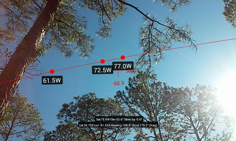

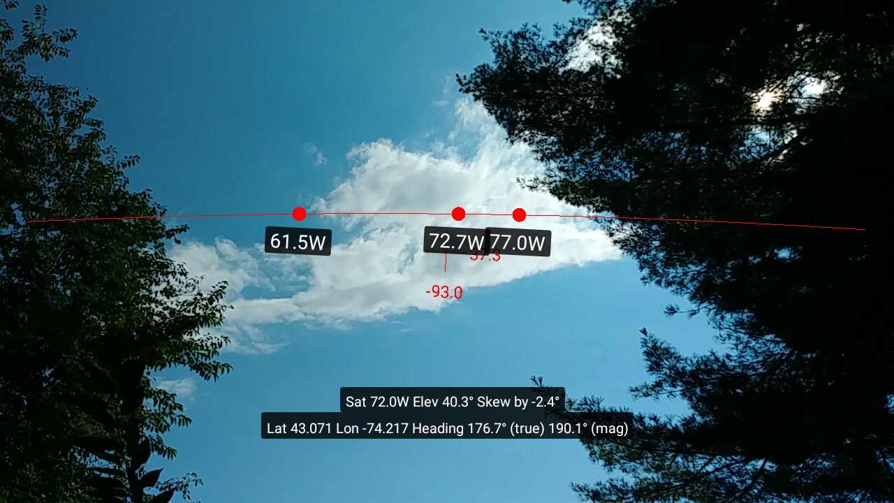

The first photo below has trees in the fov, but still gave me a 45 on 61.5 and 52 on 72.7. The second photo has even more in the fov, but still gave me a 39 on 61.5 and 44 on 77. 72.7 was obviously blocked. The 77 filled in the missing channels on 61.5, but in SD. Knowing exactly where the satellites are in the fov makes getting a useable signal a lot easier. Obviously these screen shots were made when 77 was still active. And I've been doing this for myself and others since 2008.
