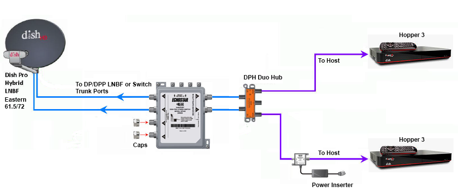

Okay, so I made an updated diagram just to make sure I understand this right...
- 2 Coax connected from outside Dish LNB into 42 switch.
- 2 Coax from 42 switch into Duo Hub.
- 1 Coax from Duo Hub into 1st Hopper 3.
- 1 Coax from Duo Hub into Power Inserter.
- 1 Coax from Power Inserter into 2nd Hopper 3.
- Power Inserter plugged into wall electrical outlet.
Did I get that right? And also, I assume the power inserter is required?

Twa Coaxes from the LNB if it's Eastern Arc (2 "Eyes") and three if it's Western Arc and yes, the power inserter, it's required

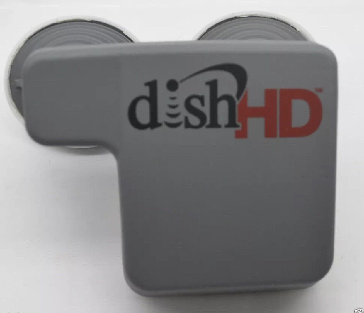

There's something I wanted to ask about. The DPH42 that I'm looking at buying says: "Requires Dish Pro or Dish Pro Plus LNBFs. WILL NOT WORK with Hybrid LNBFs."
But the LNBF I currently have outside is the DISH 1000.2 DISHPRO HYBRID TWIN (eastern arc) LNBF.
So do I need a new LNBF so the DPH42 will work? And then does that also mean I need a different dish too?
No, not a different Dish but a DPP LNBF and LNBF Bracket if the Hybrid you have now is a Slimline - which I don't believe it is.

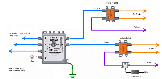

When I had my dual H3 setup done way back and I did all kinds of research since it wasn't being done and I had a feeling when I went to Retention to get "approval", they'd balk at it so I wanted to have my "Duck in a Row". I thought it was Hybrid LNB with Hybrid "Hubs" no 42 Switch needed, like here: DP vs DPP vs DPH
Although a "Training Tech" did the install, he really didn't know what to do and didn't have any Hybrid LNBs on his truck. So I got a 42 Switch install. Along with the dishes, of which I no longer need the 129, remounted. Afterwards I cleaned up and simplified it.

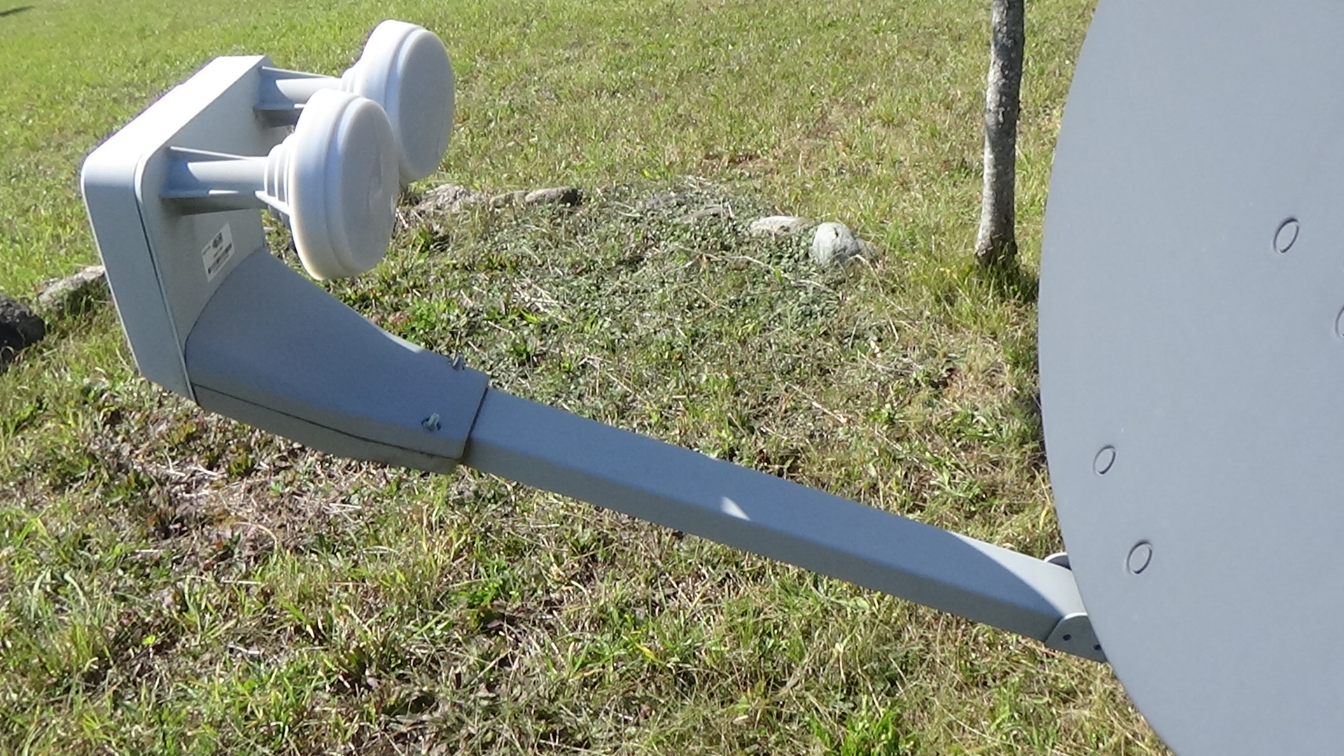

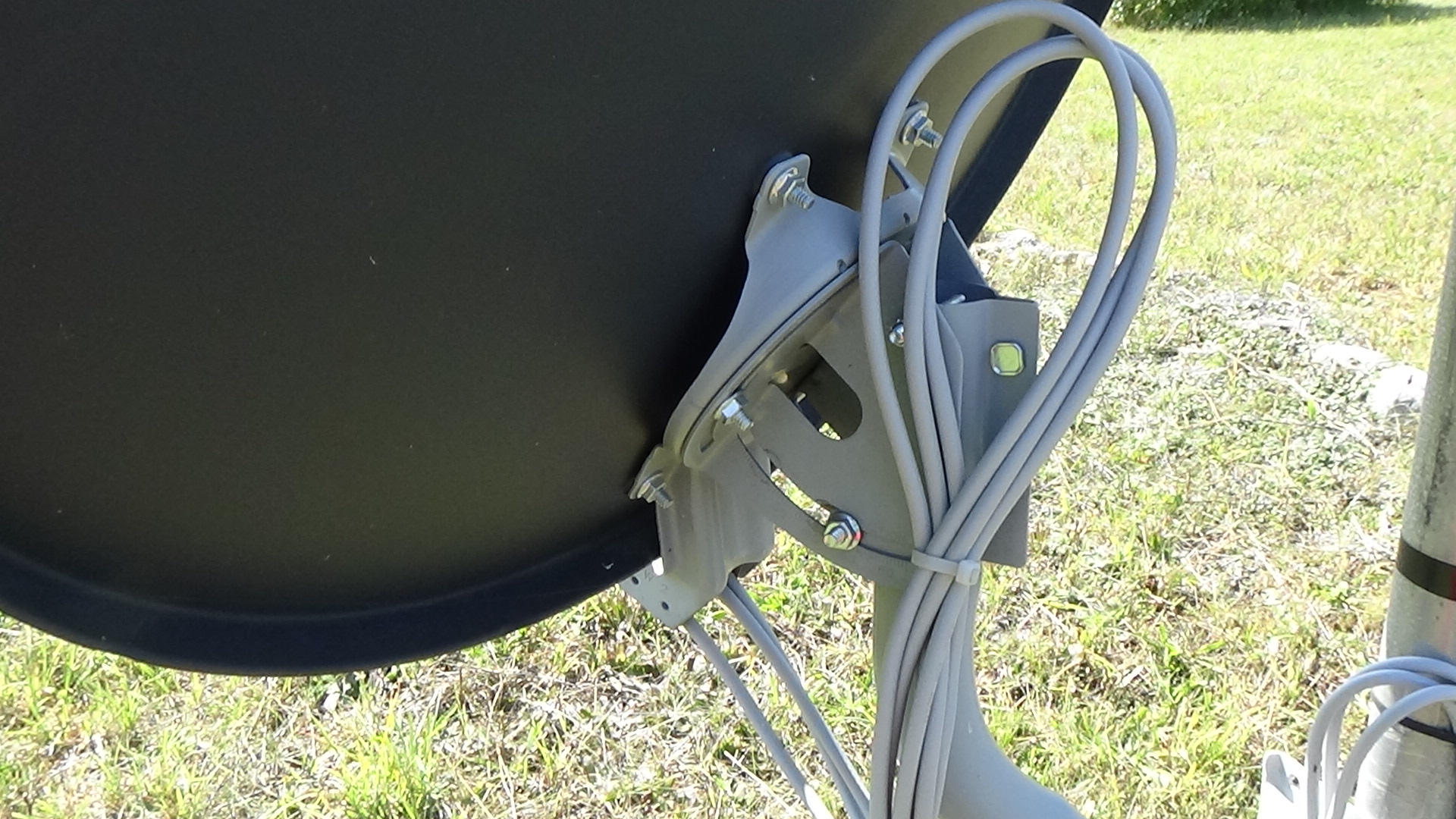

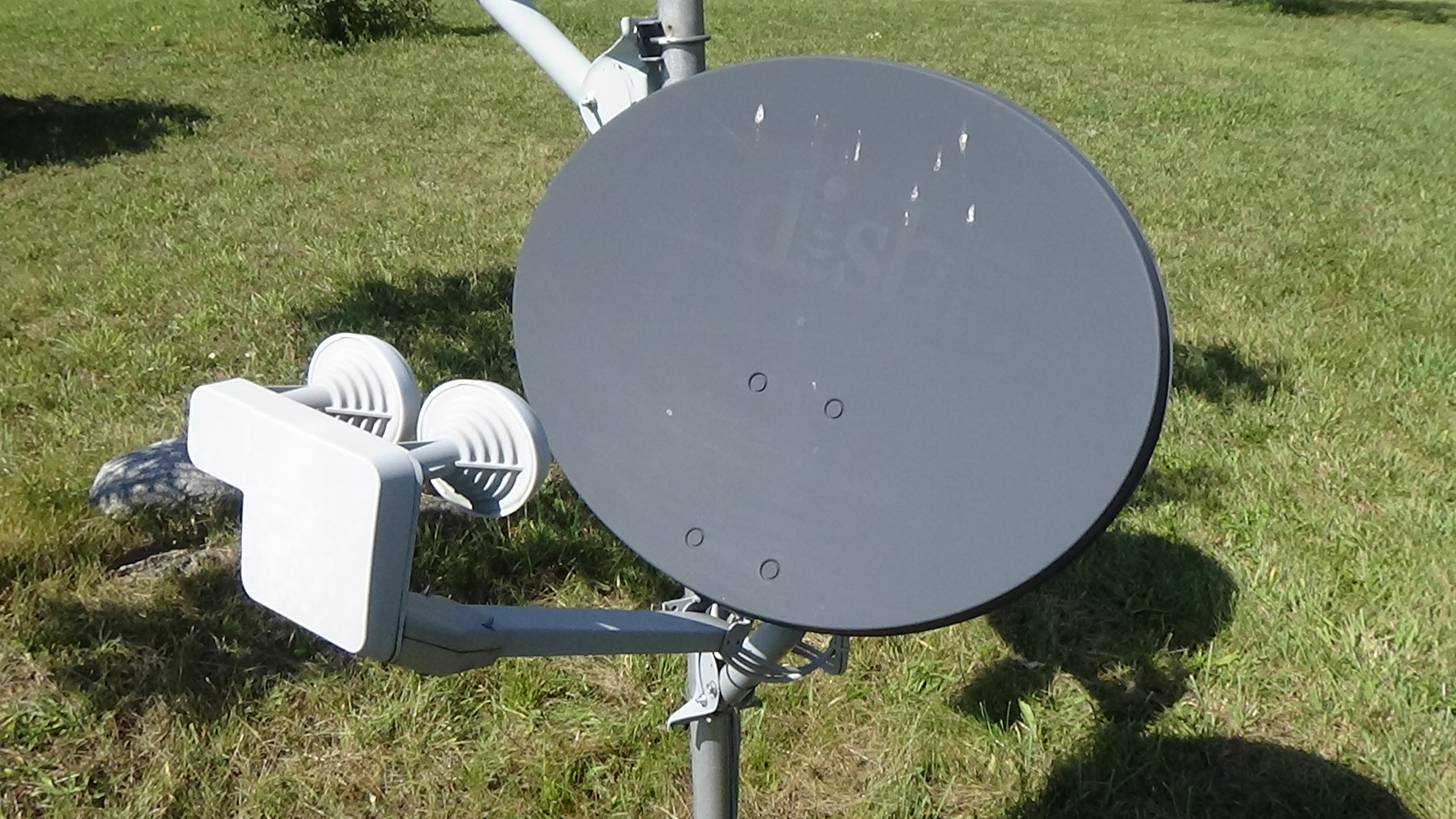

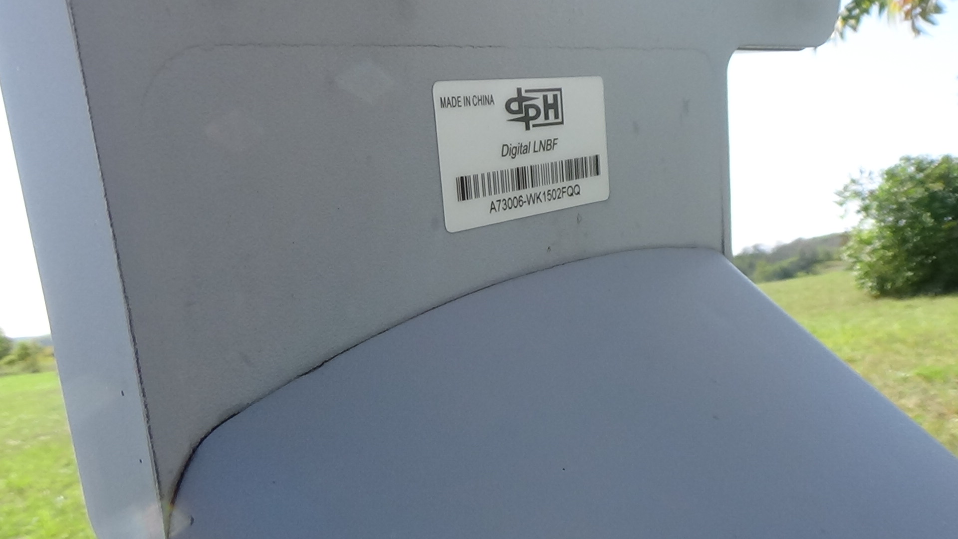

Alright, so speaking of ducks in a row, I need to pick your brain again. I just got the DPH42 switch and the power inserter in the mail.
I've attached a few photos so you can see my current outside setup, which I've been using this whole time with just one Hopper 3 and a 4K joey.
Based off these photos, please tell me that I don't need a different dish and that I won't have to re-align anything. Since I'm doing this whole thing myself, if I do need another LNBF, I just want it to be a simple "unscrew the current one, screw on the new one, everything else stays the same" type of job. And yes, this is 61.5 and 72 Eastern Arc.
Yep just swap the lnb with a dpp lnb and connect the 42 switch.

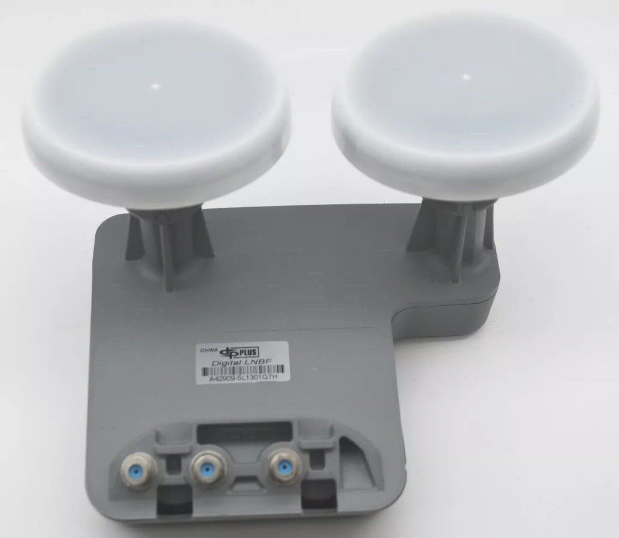

Just checking, this is the one right, Dish 1000.2 DPP Twin? And I can use the same bracket and mounting arm that I have right now?
I know this one is an A4... can't find an A7 yet... but just wanted to make sure I was getting the right one. Also, I only connect 2 coaxes to the first two ports on the left?
Yes to all your questions.
