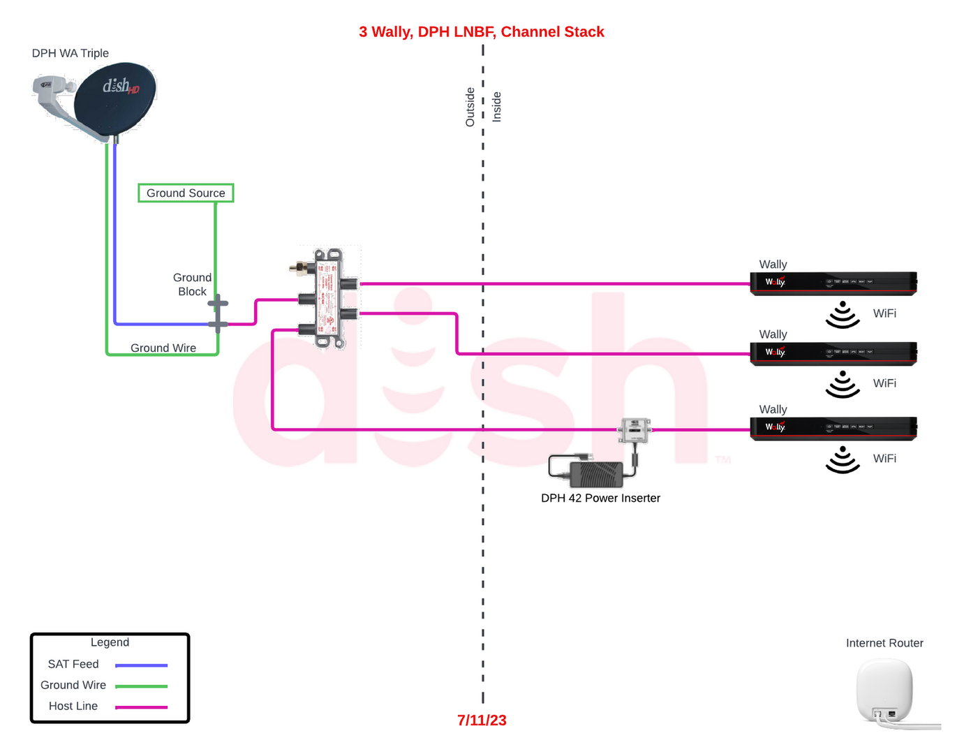

If using channel stack splitters you should be using a dpp lnb with a 42 switch and power inserter going to port 1.
I know ppl talk about using wallys direct on a hybrid lnb and even splitting it but it's not approved for a reason lol.
Not according to the diagram
