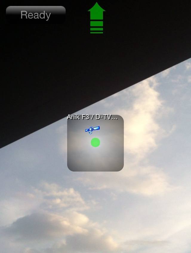

I am wanting to get Dish here at my apartment but I am having a small problem. I can only put a dish on my balcony because I am not paying the $200 to let the apt let me mount a dish outside my common area. So I have planned to do a tripod mount on my balcony.
I have attached a picture from my satfinder app (E* 119). It looks borderline as far as the elevation goes because the awning part that comes out pretty far.
I just wanted to see if I could get an opinion from the experts here and see if I should go ahead and try. I plan on buying my own equipment and doing a flex account.

From what elevation was that picture taken?

Jim5506 is correct, but from the one picture there is no way to tell for sure if it will work unless we were to have a tech on site to make that determination. Were you planning on doing an installation yourself?
I'm on the second (top) floor. I like the cement in a bucket idea rather than a tripod. I would just need it as close to the railing as possible so I could clear the roof overhang enough.
Hi Raymond, thanks for the reply. I do plan on doing the install myself since I want to do a pre-paid account (flex) so I may have to just take the risk and try it.

the lower the better in your case but since it will be lower you might be able to pull it back but giving the photo you might not have 110 that has some locals HD and programing from movie pkg and 200+ pkgs EKB: Dish Network Channels at 110° has the list of chan from every dish bird

I think you are right rocket, I checked 110 and its a bit higher and left so my awning looks like it will block that signal unless i get very lucky.

It could be worth a shot. Bolt the dish on the railing into a 2x6, this way it will hang off the side giving it more clearance. As long as it is stable, and no one gives you grief, it should be ok.
