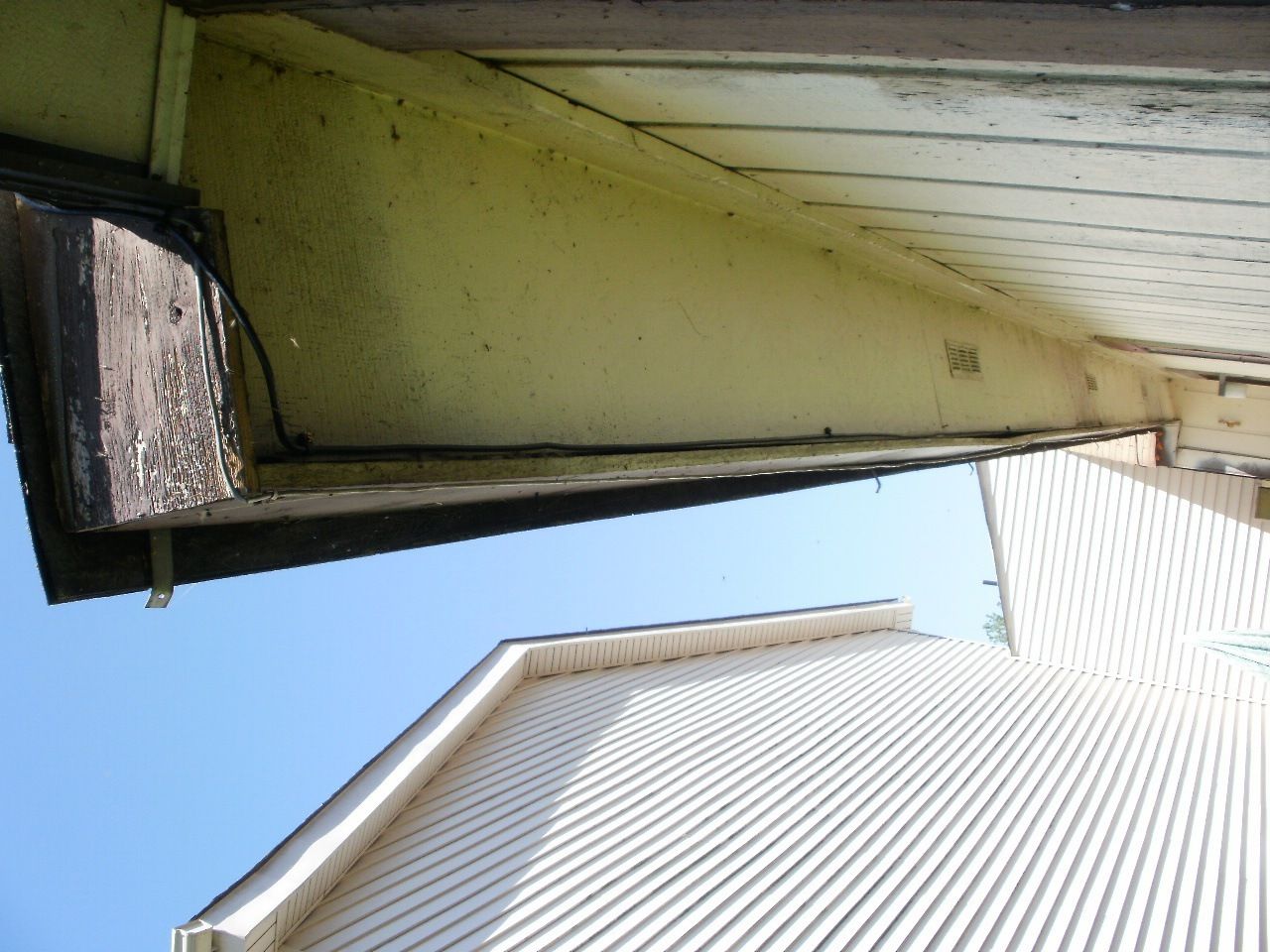

Well just got a look at my install

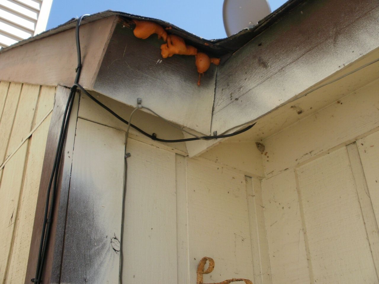

Is that third picture mounted over a living space?! :eek:
Although I (we) try to avoid it, it isn't uncommon for dishes to need to be mounted over a living space, usually for LOS reasons. Just make sure you tar the $%^& out of it and we have never had a problem.
Pix #3 doesn't look very well done. Not much tar, bolts not drilled/screwed straight in and stand offs not well placed.

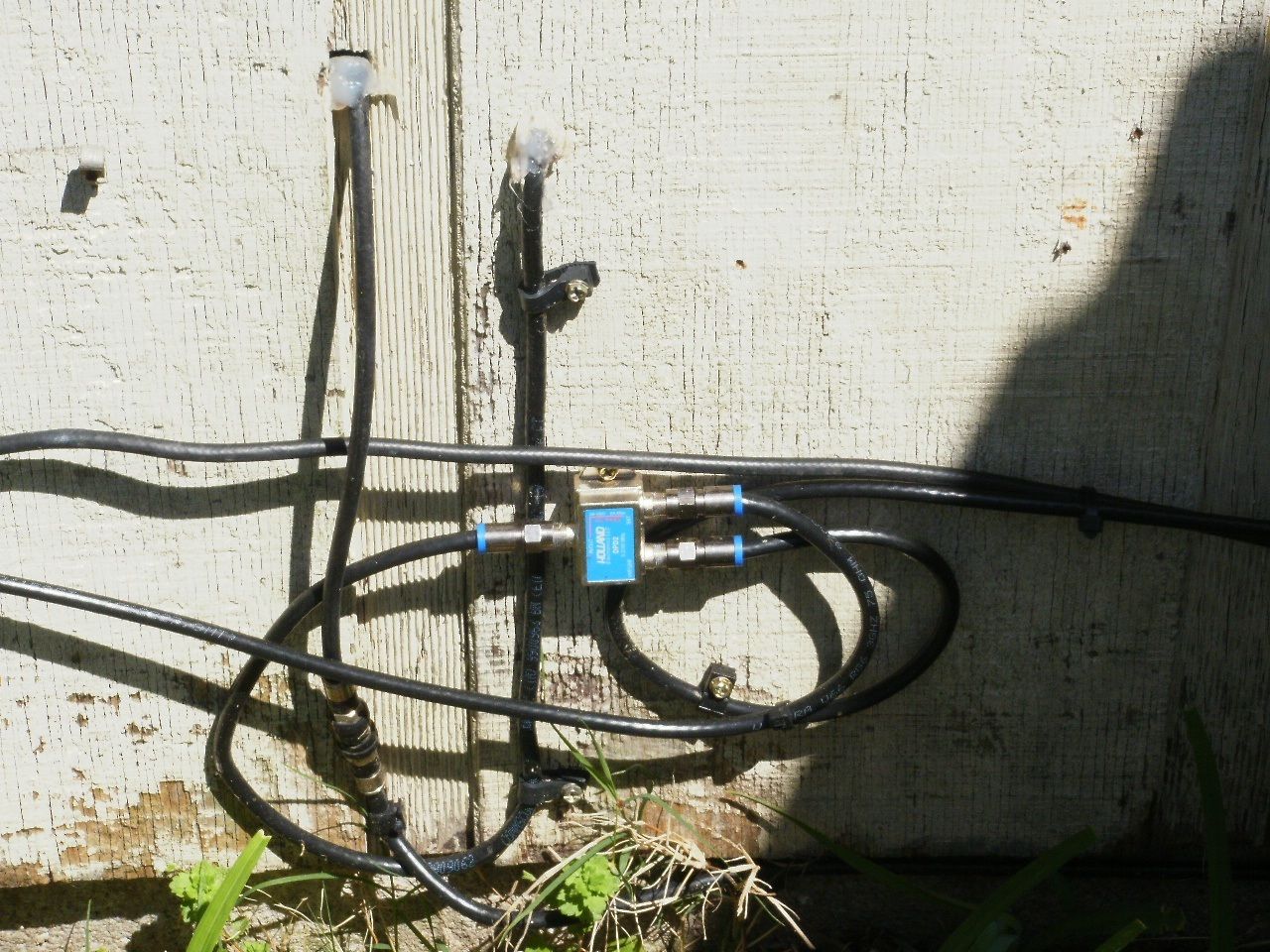

Sorry for the delay in getting these up but misplaced batteries and a daughters reward came first. The only part I'm not cool with is the last pic because he could have replaced the line instead of stretching it and leaving it like that so the line will still have to be replaced and at this point I'm going to do it myself.
I agree on the last pic :rolleyes:

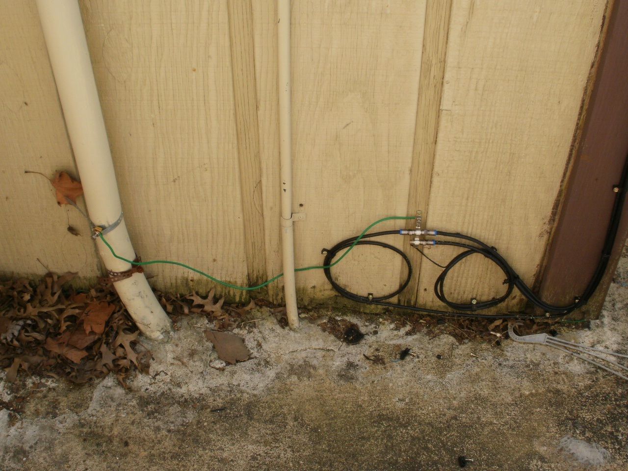

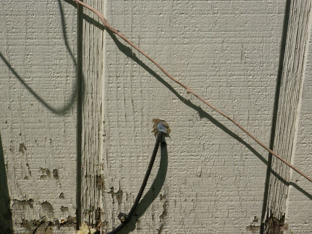

I'll admit, on a bad day I have done jobs that look almost as bad as the "fixed version" but if I was going out to redo a job as badly done as the first one I would have done a MUCH better job than that. Pix 2 could look a lot better, he didn't even fill the top left hole correctly with silicone. Pix 4 - The ground wire looks like crap, should be clean and straight and attached to the house. Pix 5 - could or should have been done like my poorly edited pix below, sorry my line isn't very straight.
Brad
Where I'm at, mounting over a living space (except on a specially designed mount built on to the roof) is an auto-fail AND a damage claim.
With 1000's of installers, I get DNSC not wanting to deal with the possibility of leaking. We are a small retailer and the boss/owner knows we know what we are doing (We have all been here for over 9 years) and isn't worried about us screwing it up. I have probably installed 100's of dishes "over living spaces" in 10+ years, we have never had a leak or complaint.
Damage claim by who? The customer that just requested it be mounted there? Antennas have been mounted "over living spaces" for 60+ years. If the customer wants it there and you are a competent installer and do it correctly, who's complaining? If I want to pay someone to place a car on my roof, and I give the OK, and sign that I requested and approved said action, I can't sue for them doing exactly what I want. Especially if all potential hazards were addressed in writing at the time. More realistically, if I want a skylight added, obviously someone is going to be making "roof penetrations". I assume they will do it correctly, seal it up and there wont be problems, I see no difference between that and mounting a dish over the living space.
