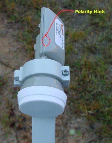

it sounds like your skew might be off by 90 degrees. When you posted the stuff on H1 that is H polarity but you got it on vertical. The Xtreme II has a notch on the side where 0 skew is which is different than other LNB's.
Turn the LNB 90 degrees then retry
see picture

The picture is showing 0 skew, right? Thanks for that tip - it wasn't in the color glossy... I thought when the coax connector was perpendicular to the ground that meant it was 0 skew, I was 45 degrees off in my mind.
yes the picture shows 0 skew
I know my coax connector is sticking out to the side on my Xtreme II LNB at 0 skew
