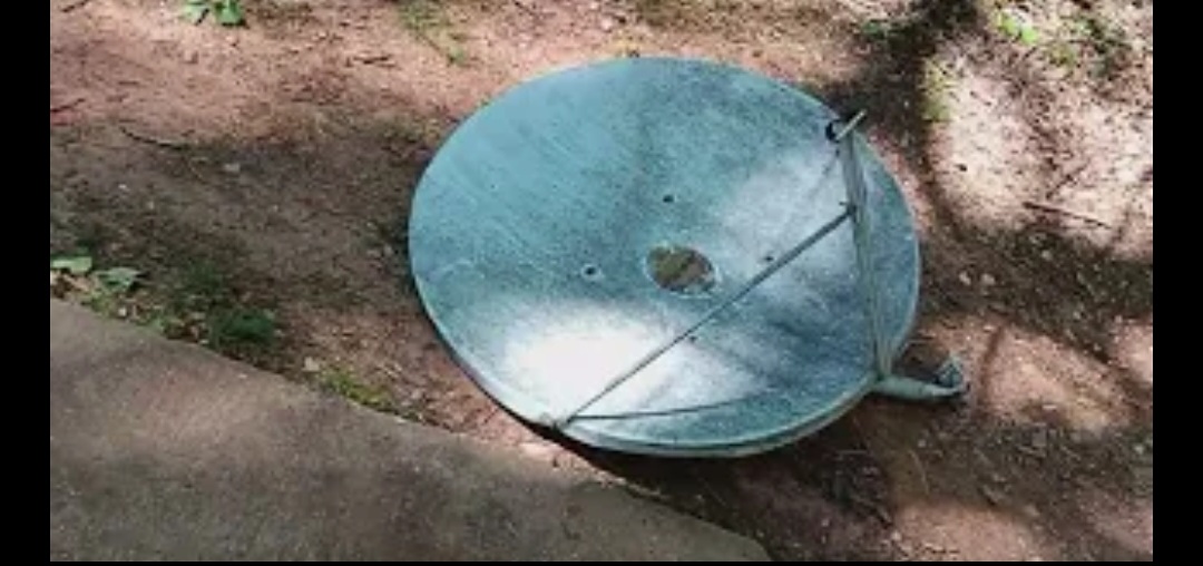

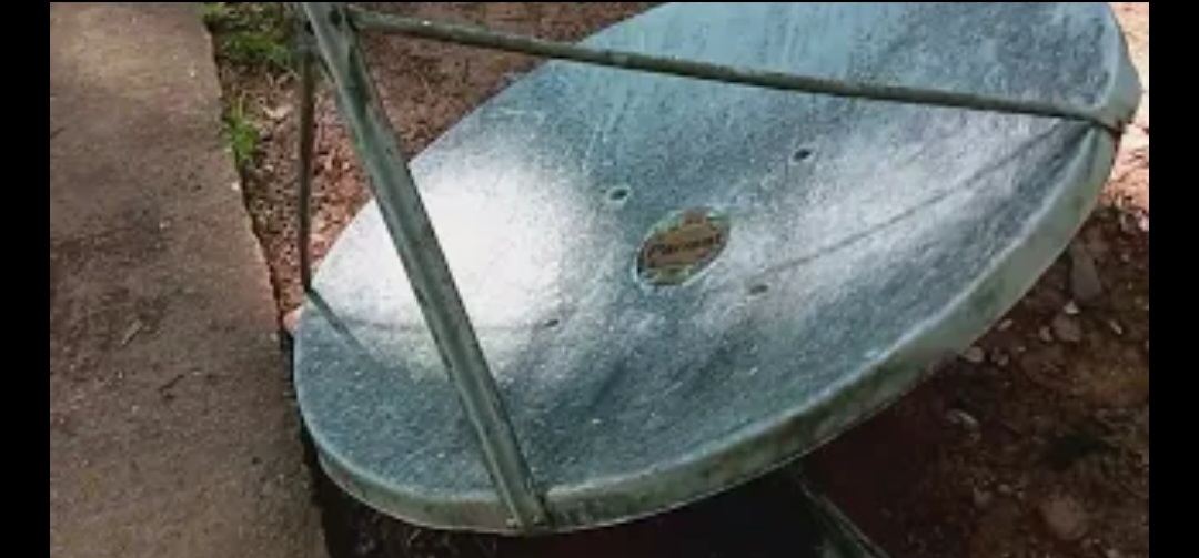

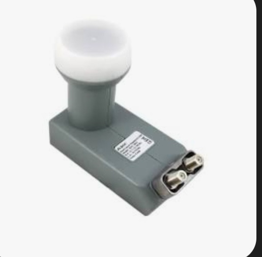

I just found this big metal dish that says panasat/panarex on it and I'm wondering if I can find galaxy 97°w, 117° or any other FTA satellite. The lnb you will se once you scroll down looks exactly like the one that was on the dish when i found it. Its NOT a c band lnb

I'm pretty sure most of you know that isn't a c band lnb but id thought I'd say that anyway
Get out a tape measure and tell us the size of the dish. As far as the LNB the pictures are not clear enough to read the label. I suspect it is for dish network, not FTA, but that's a guess. Let us know the model # and what does it say for L.O. Freq.

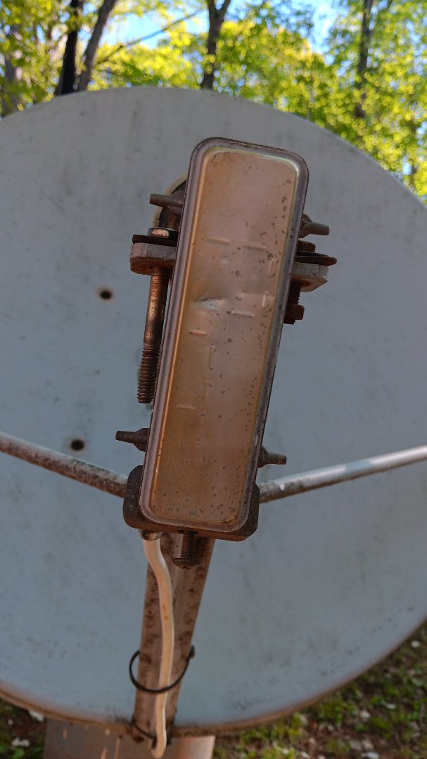

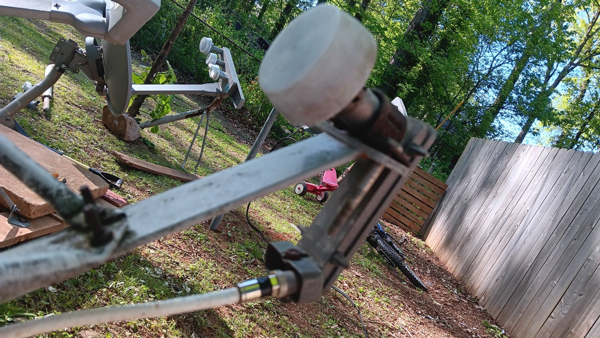

Ok I just checked the lnb and it urns out it has no case on it or any markings. To me it looks like an old directv lnb someone put on there

Judging by the pictures that is an old Directv LNB so that will need to be replaced with a new LNB that will work for FTA. It also looks like the LNB holder on your dish is 30mm diameter. FTA LNBs require a 40mm holder, so i think you will need to replace the LNB bracket too. You can try something like this:
