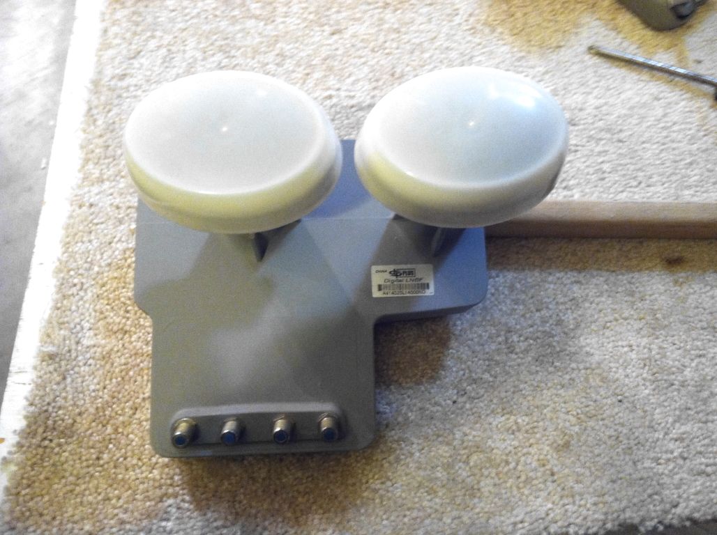

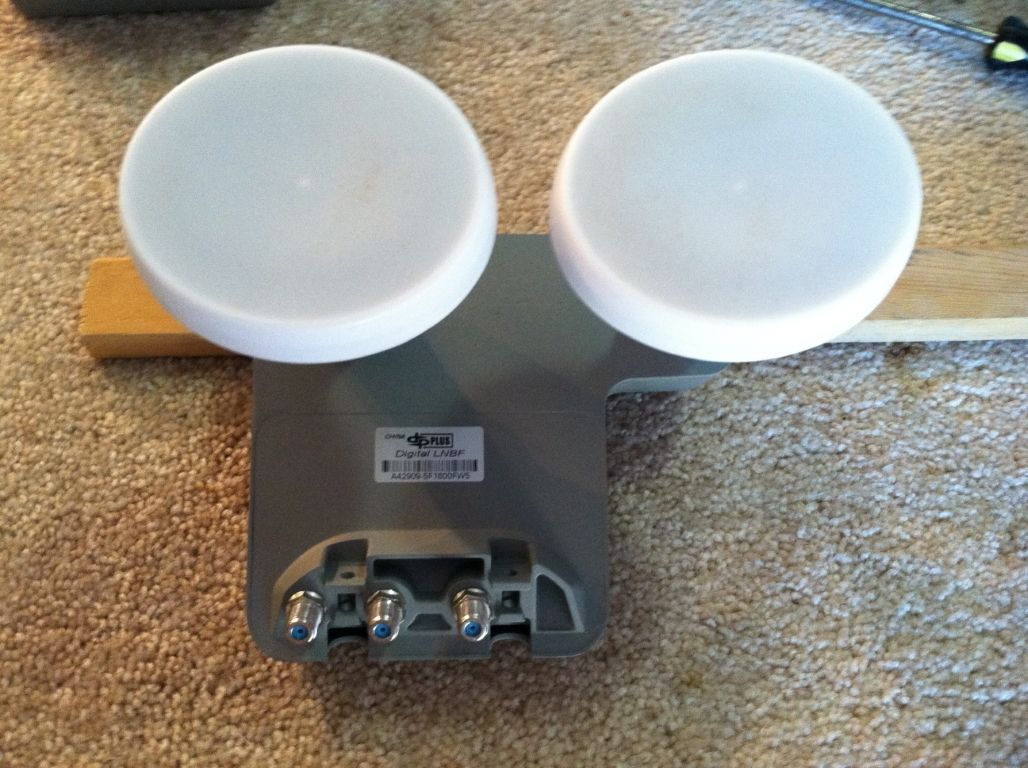

I looked for the answer to this question, with no luck. Forgive me if I have missed it.

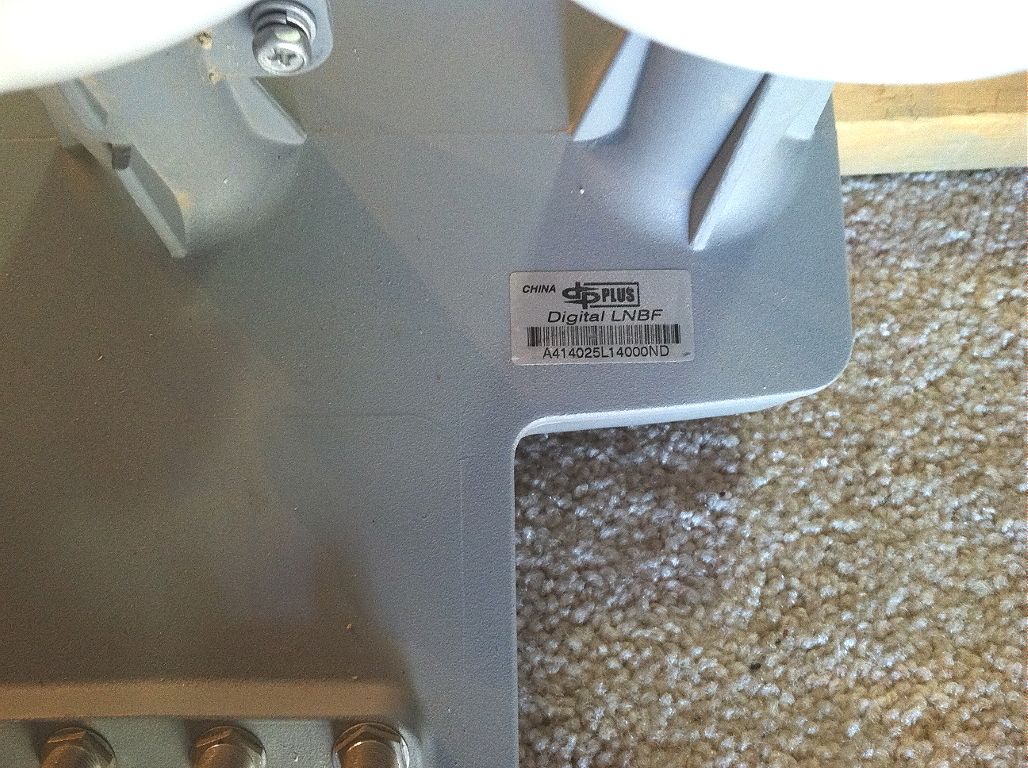

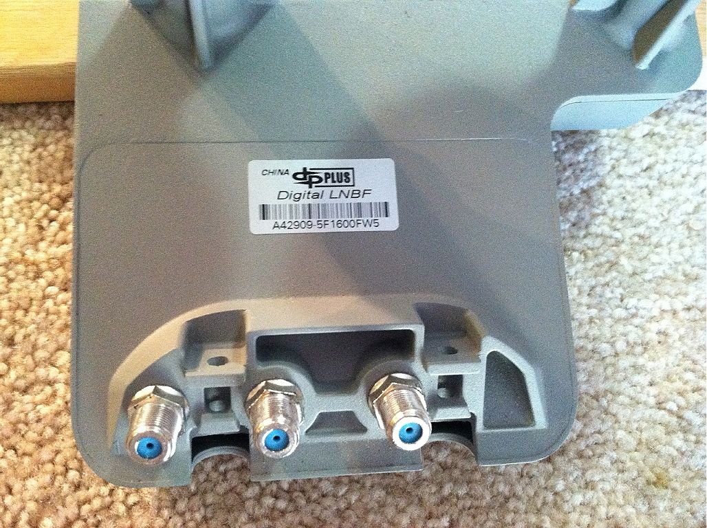

I have a Dish 500 reflector, mounted high up. It has a DishProPlus LNB, which has been damaged. I have at least two spare DishProPlus LNBs, but they don't physically look like the one that is in there now. They don't even look like each other. Some have round windows, some have slightly oval windows, some have very oval windows. On some, the windows are 3-7/8" apart center-to-center, on others it's 4-1/8". I would think this would affect beam separation angle. And they all have different part numbers on the label. Most of the web references I find use a number beginning with letter E, but my spares have numbers beginning with A. So for example, what is A42909-1600FWS, and what is A414025L14000ND. Is there a translation table or cross-reference somewhere that will help straighten these out?

The A42909 is an eastern arc (61.5 & 72.7) LNBF typically used on a 1000.2 dish. I'm not finding a match for the other number in my reference sources. The 110/119 DPP LNBF for the 500 dish is pictured below, although there are other setups for the 500 that use two DP single LNBF's and an SW-21 external switch.

Your picture looks like what is up there now.

Here are pics of the two LNBs I mentioned in the first post.

Neither of those look like Dish 500 LNB's.
Nuts. I was afraid of that. So what are they? Apparently "Dish Pro Plus" refers to a wide range of LNBs.
The first LNBF is a DPP500+ International LNBF. It will only work with a Dish 1000 kit and you'll need to add a sidecar, DP Single or Dual for the 129. But, not needed if the 129 is obscured.
The other is a 1000.2 Eastern Arc LNBF for use with a 1000.2 Dish Kit
