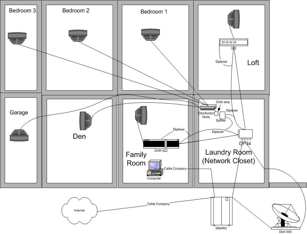

I am in a similar boat - I have a two-story home wired with RG6 and terminated in a single location. With help from this forum :D , I setup the wiring such that I can receive the TV2 feed from either of two dual-channel receivers in any bedroom. I have one TV2 out set to channel 21 UHF, the other to UHF 26. By tuning the bedroom Tvs to either channel, I can choose which receiver to use. I assume you can do the same with external modulators.
Attached is a wiring diagram, I hope it helps. Notice the standard coax splitter combined with 2 diplexers and the 24db amplifier in between the splitter feed and the distribution node.
Hope this helps!
- Flappy
Hope this helps!
- Flappy
Are you combining the cable and satellite signals into one cable ?

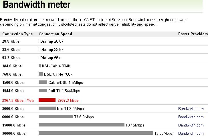

Just for giggles, I attached a screenshot of a CNET bandwidth test from my main PC. :D
- Flappy
- Flappy
That's some good speed there Uncle Flappy ! I haven't run the bandwidth test in a while -- I should probably do that as I have already added one splitter to the line. I can then compare the degradation in bandwidth after I add another splitter down the line.
