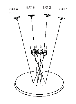

Put the LNB for IA-5 to the right of the main LNB as the signal bounces of the sides of the dish into the LNB!
I may have originally stated things in a confusing fashion. Standing in front of the dish, viewing the LNB from the rear, I am placing the IA-5 LNB lower and to the left of the AMC4 LNB. Is that correct?
Sounds right!
Facing the dish, it going down in sat deg rt to left. so if you place it on the left side of AMC4 (101), then it should be good.

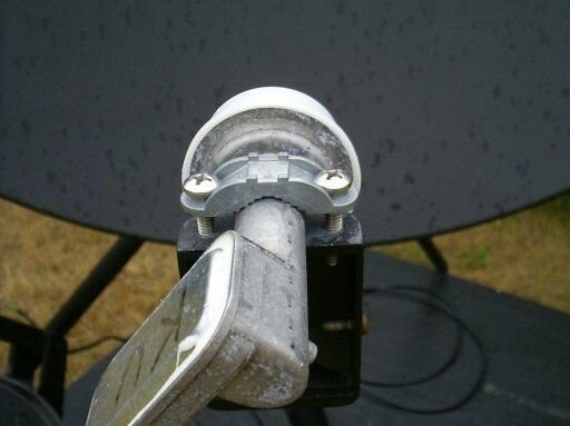

Remember you can crack open the casing of an LNB very often making it a lot smaller (As well as exposing the 20mm neck).
The casing on an LNB does not make it water tight, most all of my Ku LNB's have been modified in this way. Of course its done at your own risk.
But I have never had a bad LNB in all the time I have been doing it! A file is also your friend.
