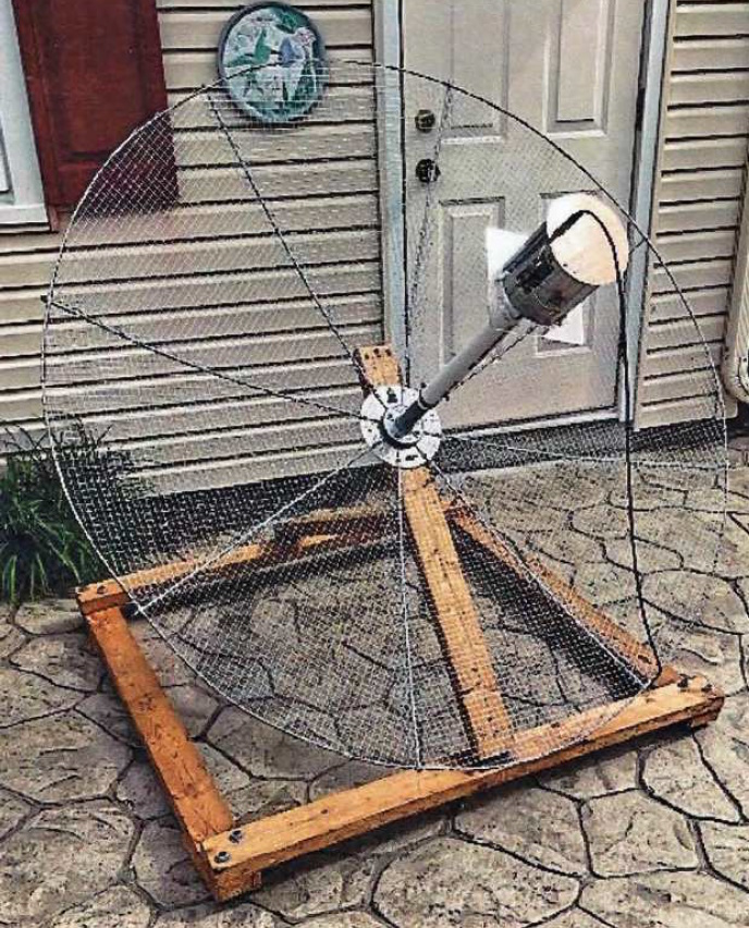

Using a 12-foot dish should be easy for this task. Note attached that talks about an amateur radio operator who made his own 5-foot dish for the same purpose. Courtesy of July/2024 issue of QST magazine from ARRL.
