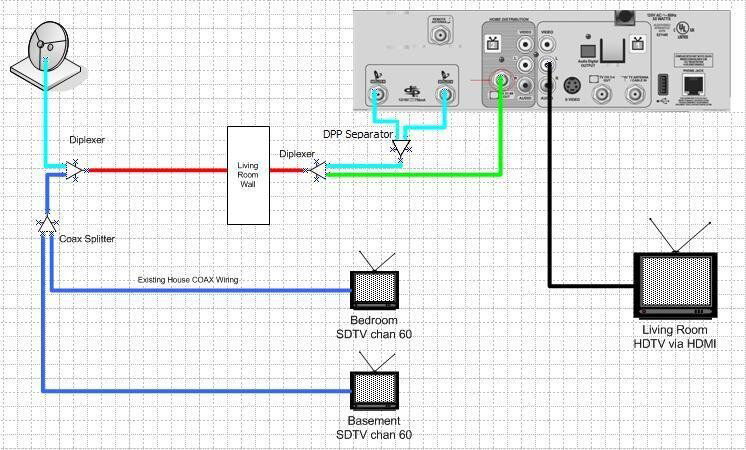

If you already use the 322 for *two* Televisions ... then what happens is TV2's signal is probably coming out of the back of the receiver and going into the wall. The other option is for TV2's signal to piggy back over the same cable that comes in for the Satellite signal ... using "diplexers" (pair, one to put TV2 on the wire, one to take it off the wire).
*if* your intention is to move the 322 into the room that is currently serviced as TV2's room .. you just have to get the wiring right to where the 322 is now, and it will extend easily. Check out this diagram as a version of how most dual TV support systems are setup when using diplexers.
You can ignore TV3 if you want.. etc.. the important actions are happening on that "red" section of the cable inbetween a pair of diplexers.
If this doesn't match your setup .. you would need to see what else you have hooked up and where..

Ok.. so if what you're saying is that the wire comes in .. goes to the receiver (coax) ... and then there is a Coax that went from the back of the receiver to TV2's location .. then yes, put a barrel connector on the Sat cable (disconnect from the DPP Separator), connect it to the cable that currently heads down to your TV2 ... and then move the receiver to the TV2 location .. unplug the coax from your TV and plug it into the "Separator" and you should be good to go.
The specs are 200' of RG6 from dish LNB to receiver. So long as you're within that range you shouldn't have an issue.
Be sure to high-pass rated (2.2 GHz or so, 3.0 is better/best) barrels/unions/couplings on the satellite signal from the LNB.
