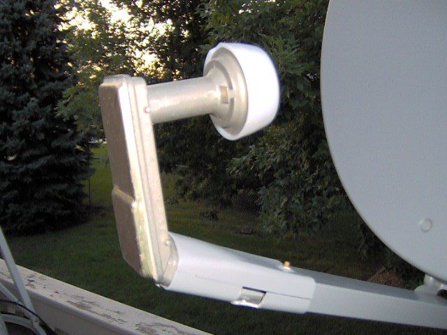

Back to opening-up-an-LNB. Does anybody have any pictures of what's inside of the different types of LNBs? I'd be interested in seeing exactly what's inside of those things.
Here is what an old Stacked LNB looks like with the cover off
The newer ones dont have the "pregnancy" at the bottom :)
Display a picture
