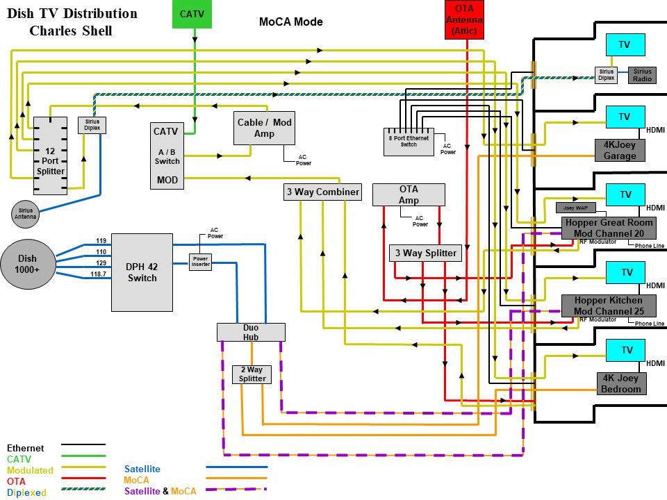

Charles, do you have a diagram of how to run that jumper?
I use a Duo Hub so both my Hopper 3s see each other. For two Solo Hubs setup you run a coax from one of the Solo Hub's Client port to the other Solo Hub's Client port.

Makes perfect sense! Thank you! I also want to see how to get both Hoppers to connect to the MOCA network over coax!
