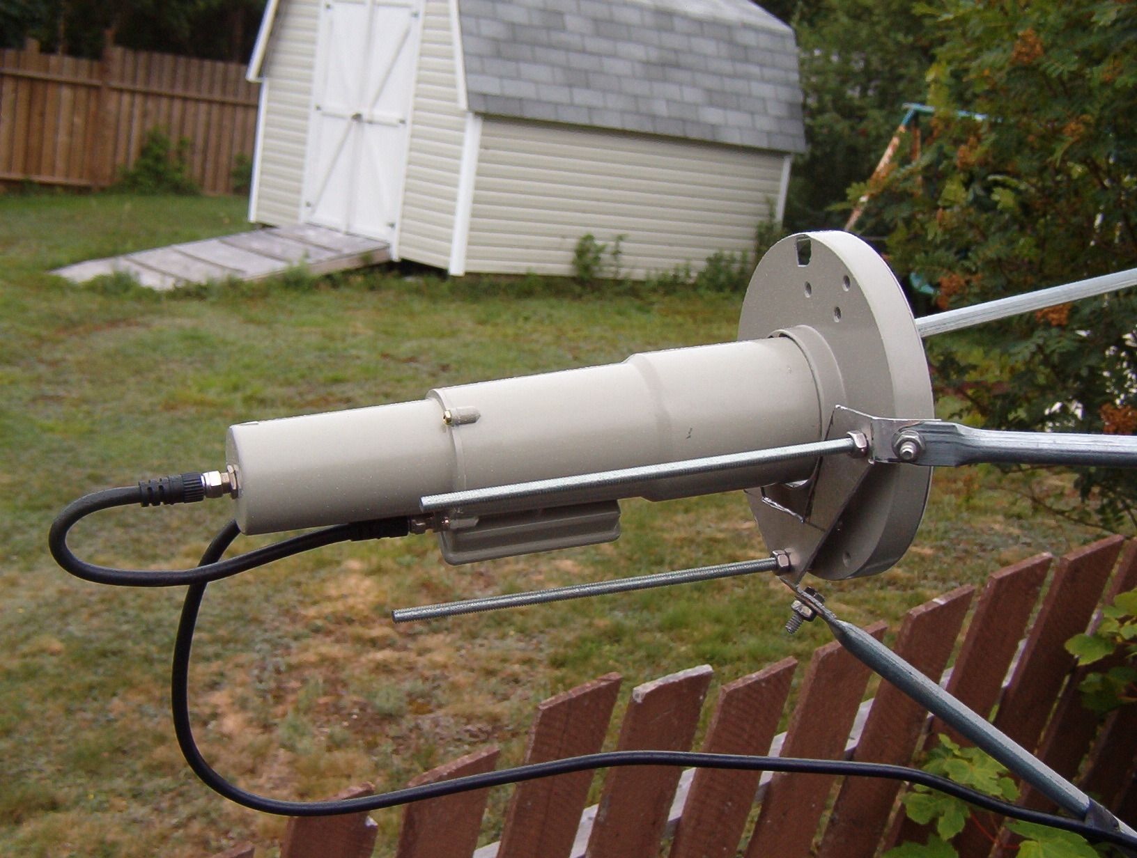

I tried the 621-2 with my 1.2M Andrew fiberglass dish and did have some success with the C band but did not record or list what I could get at that time but did see some TP's on most of the popular sats.I was a little fustrated with it as the KU section was not at all as good as my single ku lnbf as alot of the Quality was around 63% on the coolsat and there you may or may not get a picture, my single lnb would show 80-90%.So this was a couple of months ago and have not gotten back to it since.I may try again soon.
Dave
