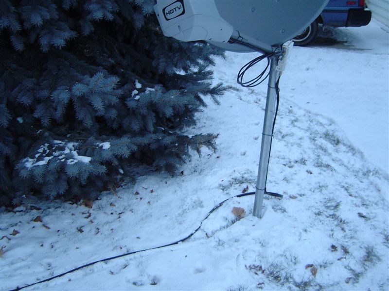

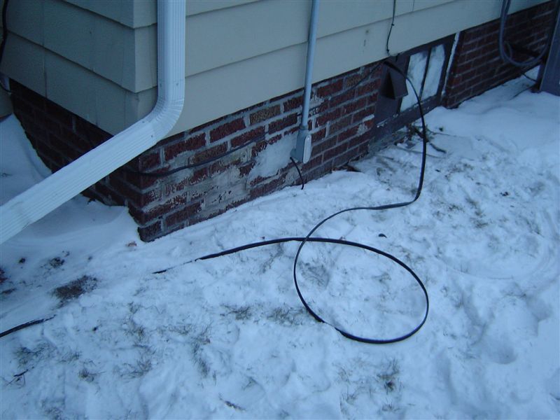

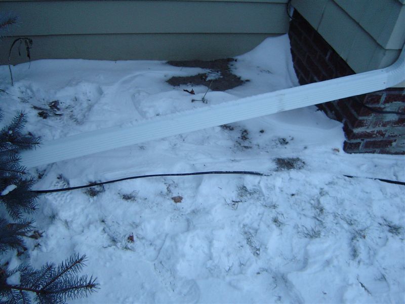

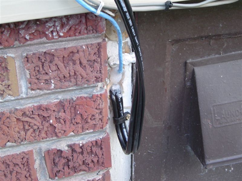

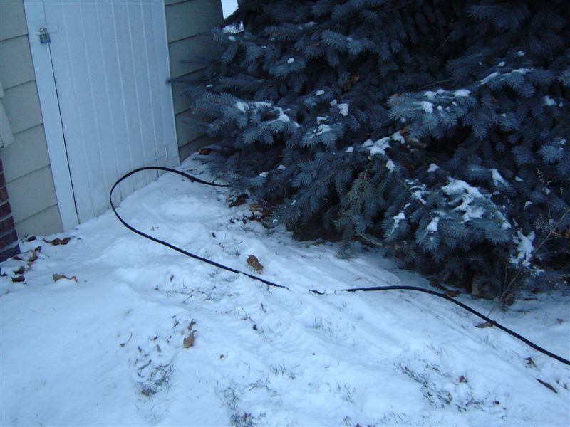

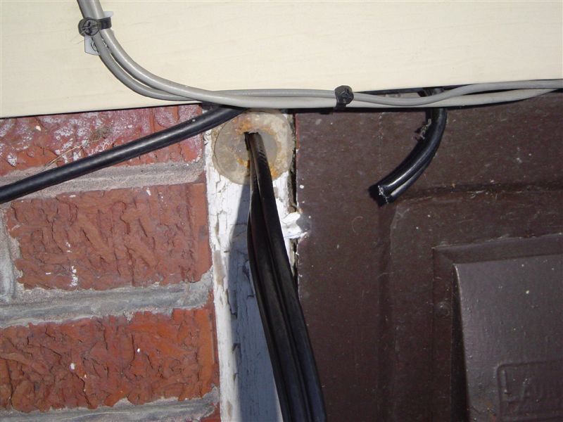

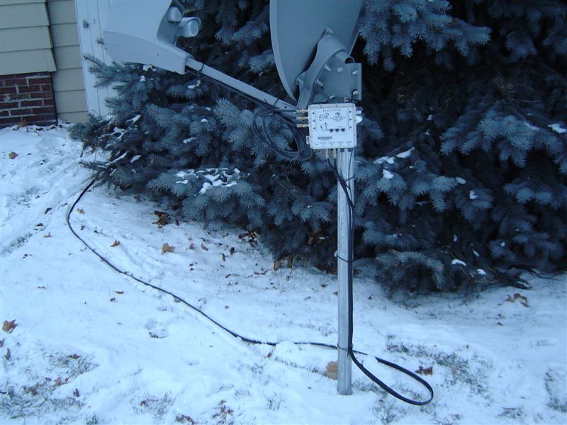

Here are my photos of the "original" install. Left it a mess, mounted it where I didn't want it (again I was at work, my wife was sick) and cut my cable wire coming into the house. Oh and stole a high quality splitter I had in the basement)
And btw, this installer told me that the original installer has since been fired and his company told him to take pictures of the last install and pictures of what this installer had to do to fix it. In turn his company will be sending the original (fired) installer a bill for what it took to fix his install.
I will be posting the new install in a few.

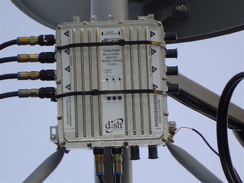

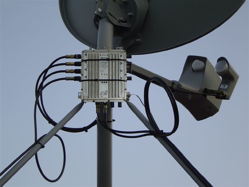

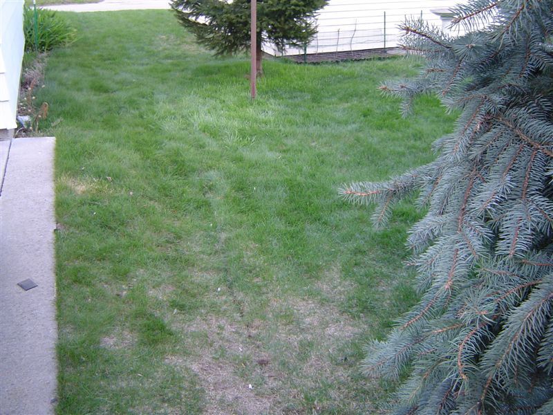

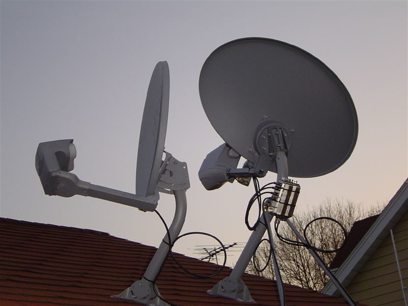

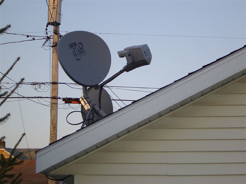

Here are the pics of the new (correct) install the way I wanted it. Superdish and 61.5 sat.
Can hardly even see the bury! :D

Very nice job! It's good to hear about these types of installs.
Call it an overly anal eye for detail, but our QC guy would have a fit with the 61.5 having a DP Twin instead of a Dual or (better yet!) a Single. Otherwise, your installer did good
first install what was wrong
I dont see what was wrong with the 1st install other than he did not bury the coax, the ground was probably frozen when he did it, would have to wait for the ground to thaw to bury the coax
I hope you are joking on your statement. Better yet i hope you are not a installer and would leave this mess at a customer home.
t
Yes ground was frozen so you are right they couldn't bury. However, It was a crappy install as my pics show. The system wasn't even grounded, though he said it was. He slipped the coax through an existing hole that the cable company had used after he cut the cable. Seeing that the hole was too small he actually cut off the ground wire and only fed the coax through. Hense it was not grounded. Dodge...Go back to Dodge... :D
:rolleyes: you still could have done all the work from the ladder, trust me we have plenty of snow up here. Only roof installs we don't do is if we have to get off the ladder in the wintertime.
