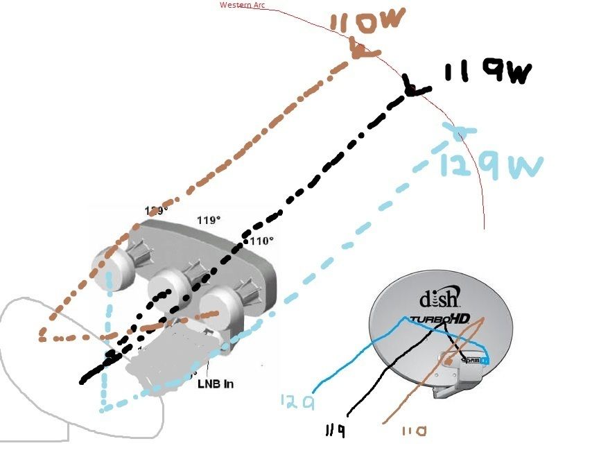

I have moved the Dish off to the corner of my roof due to trees over growing my previous location. I am able to get 119 and 129 at 60 on signal strength, when I go to 110 it shows 50+ but it says not locked and wrong Sat 129. IS the Sat. location 110, 119, 129 respective when looking into the sky at(in my case) 209 Azimuth

Thinking that 110 would be more South than 119 and 129 I moved it and still issues. I found this pic, is this a good reference? See attachment

you need to run a checkswitch to find out if you aimed it right or not. go to menu 6-1-1 point dish. note what it says there (what is listed will be the previous and correct configuration) then test it.
as far as physically looking at the sky:
110 is left 119 is middle 129 is right. 129 is low, 110 is high, thus the skew setting. point dish screen will give you some (but not completely accurate) azimuth and skew settings.
the great thing about point dish is that you can turn the volume way up, go out to the dish and HEAR if you adjusting the dish properly or not.
