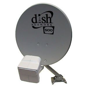

Now, can I use my DISH 500 (110, 119) with a separate DISH 300 to look at 118.7? I have a spare single DishPro LNBF to use on my existing DISH 300, as well as a DP34 switch to conjoin my signals. I read online somewhere that the 118.7 bird uses a different signal technology that requires a DISH 1000(.?) with a new kind of LNBF. What's the deal with that? Do I have to go spend money on a whole new dish and LNBF? What's wrong with the DishPro ones I have? I got these dishes and LNBFs for a song. A whole new dish would be expensive.

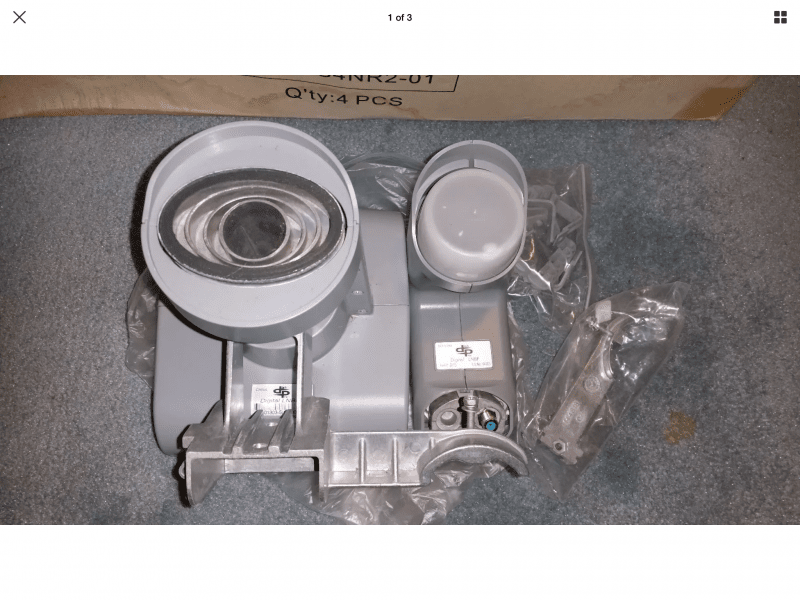

118.7 requites a special lnb, referred to as the plus lnb (the BIG eye below).
It comes with the Dish 500+ and the dish 1000+.
Jim5506, thank you for the clarification. So will a standard 500 reflector suffice to pick up just 110°, 118.7°, and 119°W? If so, all I need is the plus LNBF? Then, if I wanted to pick up 129° in the future, could I use a DISH 300 with DP LNBF to catch that bird? Would this be interfaced with a DP34 or does the plus LNBF have its own internal switch? And would this all be compatible with my VIP211K?

You need a 1000+ Dish with a DPP500+LNBF. That's the only thing that will work for American and International channels. Add in a DP Dual or Single if you want the 129 for HD

A Dish 500 will not work for 118. You will need a Dish 500+ or a Dish 1000+ and the appropriate LNB's.
We posted at the same time and you even included a picture. :)
That's the new style LNB assembly that has the built in switch. I like them so much better than the old ones that also needed a switch.
Yeah, the switch mostly, but also the 2nd side car for the 110 and having to check each LNB separately? Ugh
Reactions: Demetrax1
The 500+ and the 1000+ both use the same reflector, which is larger than a normal Dish. This is because a larger reflector is needed for 118.7 signals. The difference between the 500+ and the 1000+ is that the 1000+ has the additional LNB for 129. There are two different kind of "plus" LNBs. The newer style (with the switch built in) has an input to add 129, so no external switch is needed. The older style would need the DP34 (for 110, 118.7, 119) or a DPP44 for 110, 118.7, 119, 129. Any of those configurations would work with the ViP211k.

Thanks everyone. So if I understand correctly,
I can't use this reflector? It was designed to pick up 110 and 119, why can't it pick up 118.7 too? It's between 110 and 119?
Using this LNBF, of course. :-)
Using this LNBF, of course. :)
Once again, a Dish500 won't work. Dish uses the Ku payload of a Canadian satellite at 118 called Anik F3. It's an FSS satellite and the rest of the fleet at 110, 119 and 129 are DBS satellites. The frequencies used for an FSS satellite are different and 118 needs a larger size dish. That's how they manage to have 118 and 119 so close together. Normally DBS satellites are at least 9 degrees apart.
