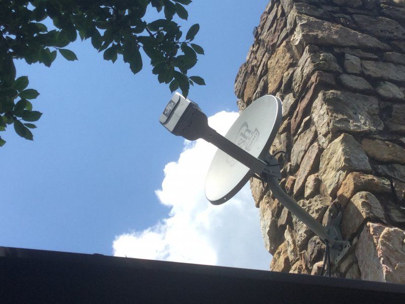

I have decided to supplement my DISH 500 (110, 119) setup with a DISH 300 pointed at 129°W. Rather than going out and buying a DISH 1000, I'm doing it this way. I'm a little leery, though. I've heard of people consistently losing signal on the 129 bird, that's why I'd rather give 129 a dedicated dish. I'll take my chances. The real problem is that my VIP211K will not give me the necessary data to tweak my satellite dish. I've tried dishpointer.com, but I've noticed that the numbers it gives me are slightly different than the ones from my receiver. My ZIP code is 24018. In the end, would it just be easier to scrap the 129 idea and aim for something on the eastern arc? Thanks in advance.

My locals are ZIP code 24018 Roanoke, VA. My problem is I mounted my 300 dish on the side of my chimney but I can't swing it far enough to the left to catch 129 because the rock is in the way. I can always remount it on the same side as my 500 which has a clear view of the eastern arc. As for 61.5, the only reason I was asking is because there is already a bracket in place over our deck from our old DISH installation which has a clear view of the eastern arc fleet of satellites.
It would appear that your Roanoke HD local channels appear only on 129. If I were you, I would change out that 500/300 dish/s to a 1002 WA dish and place it where you have a clear view of 110, 119, 129.... Then all of your issues will be gone.
or swap out that short mast for a 500+ mast that we use for internationals. It'll get you further away from the mount,

Thank you, that might be wise for me in the future. That's weird though, right? The fact that Roanoke locals are on Western arc instead of Eastern arc...? It would honestly be so much easier if they would just do a true split between both arcs. Localities that are better suited for EA should have locals beamed to EA, and the same for WA. In my greater municipality, I've seen a somewhat even mixture of both EA and WA setups on people's rooftops. In the end, I may just end up getting our HD locals through our roof antenna. We live less than 2 miles from transmitter site(s).
