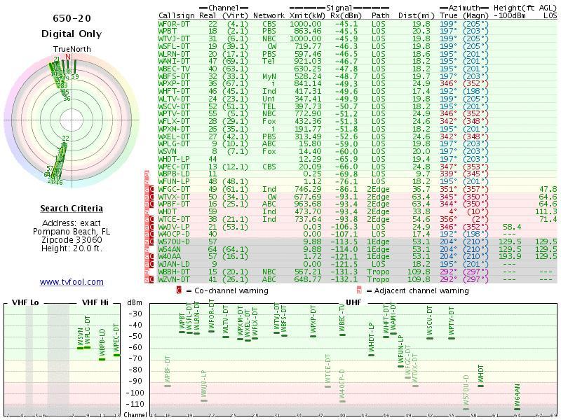

Considering I have 3 TVs, and the "mast amplifier" idea only seems to work with one TV. Is it best to have a "distribution" area or room where I have the down lead arrive and and then do the split.
Basically, what I'm saying is I don't know what I'm saying! HELP!

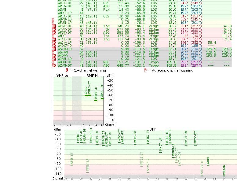

I'm at a point where there are 2 channels I'm not getting and I know I can get them but I'm not sure if it's worth amping up or moving from the small mast to the larger mast. If I have to take the large mast down, down comes the FTA satellite and motor for a while and it's such a pain in the a** to lower that mast.
I wanna receive WTVX-DT and WPBF-DT, the rest of the channels I care to receive are in the "green" section.
My coordinates are 26.239288 latitude North and -80.11777 West (decimal format for TV fool)
Here are the TVfool.com pictures of my situation. Thanks for the help in advance.

As a result of studying your post, and the TvFool site, I see several things . . .
- you are trying to get signals from two directions, so you need two antenna, and a way to combine them without causing interference.
(how do you feel about a switch or a rotator?)
- you have an adjacent channel problem with WFGC being stronger on 49, than WTVX on channel 50.
(turn your antenna toward channel 50)
- there are already CW and ABC stations south of you, but you also want the northern channels.
(... uhhhhh .... why?) - :)
- there is some sort of obstruction north of you (that 2-edge diffraction) but raising your antenna to 65' would clear it.
(probably not necessary, but it would help. Can you do it?)
Switch? Could use a rotor for one antenna on the UHF department. Do the antennas have to be on the same mast? It's a line of sight issue. That's all. Is it possible to have the antennas on different masts on different sides of the house? That should hopefully work. One would think it does.

RTN is on the West Palm CW and the ABC up north shows weekend Wheel of Fortune. Pretty well upset that there is no RTN in my DMA yet. I figured I'd aim for WTVX.
Yea I can do it, I just don't wanna put an antenna rig on the bigger mast and then find out it makes no difference. The mast only goes up 40'

The green ones come in fine, the only red ones I'm after are the 2 aforementioned stations. WTVX (CW with the RTN subchanel) and WPBF (with the weekend Wheel of Fortune)
This is the dilemma of living in the midst of 2 DMAs. :/ I spend more time twirling the antennas on an untightened mast just to fix the signal strength for both directions. Only problem is that the 2 antennas are NOT identical. One is a standard style VHF/UHF combo aimed for Miami-Dade (south) stations. The UHF yagi is meant for the north. Guess it doesn't really help having a huge pine tree in the front yard blocking the view of the UHF.
If I move the UHF yagi to the larger mast, there is no issue on LOS. I just don't wanna rely on a rotator. I wanna have fixed positions.
