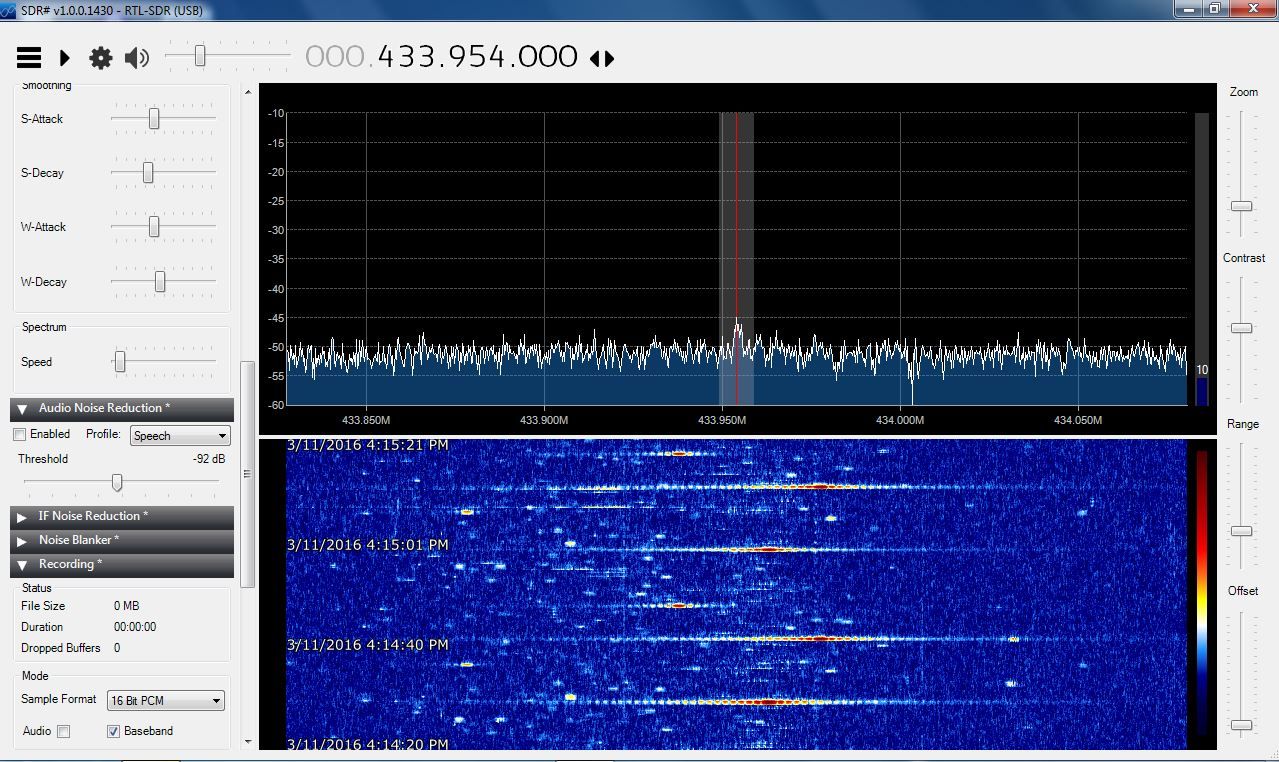

There are a couple of ISM (Industrial, Scientific, Medical) bands inhabited by low power wireless devices such as wireless car keys, remote weather stations, wireless wall switches, etc. One in use in the USA is the 433 - 434 MHz band. You probably have some device at home using this band.
Hooked up my dongle (okay.......my RTL-SDR dongle that is) to a dual-band ham antenna (2m/70cm) located high atop a building where I work and let it run for a while to "see" what signals were being transmitted from wireless devices. Even though they are low power, the dongle detected some strong, some weak ones.
See attached waterfall. Interesting stuff.
I hope my boss is not reading this......

That screen shot is SDR#, the same one I use.

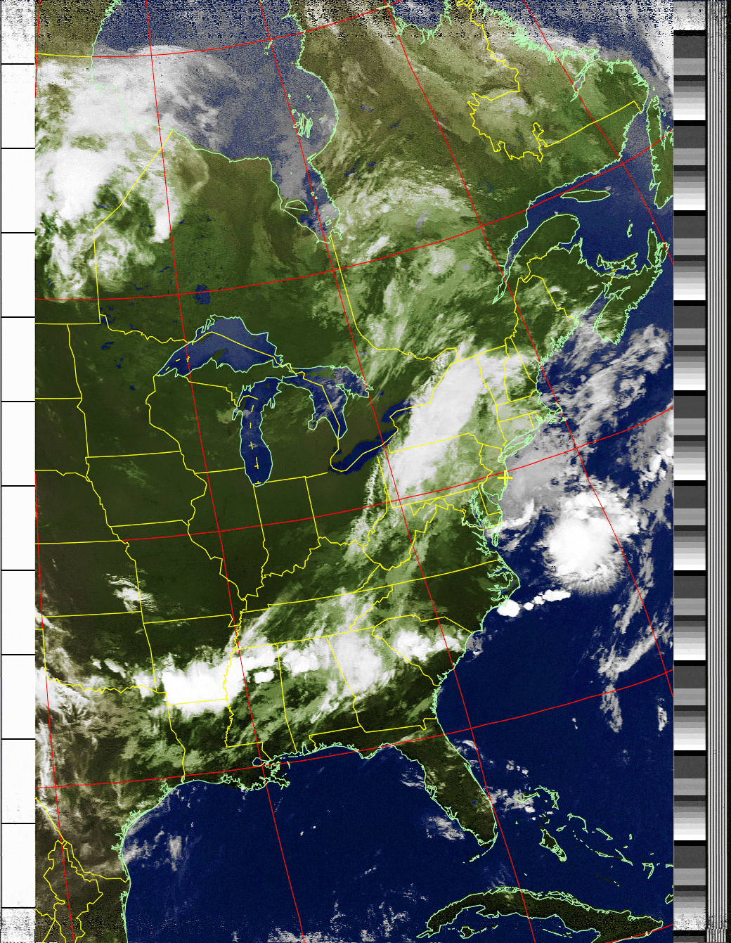

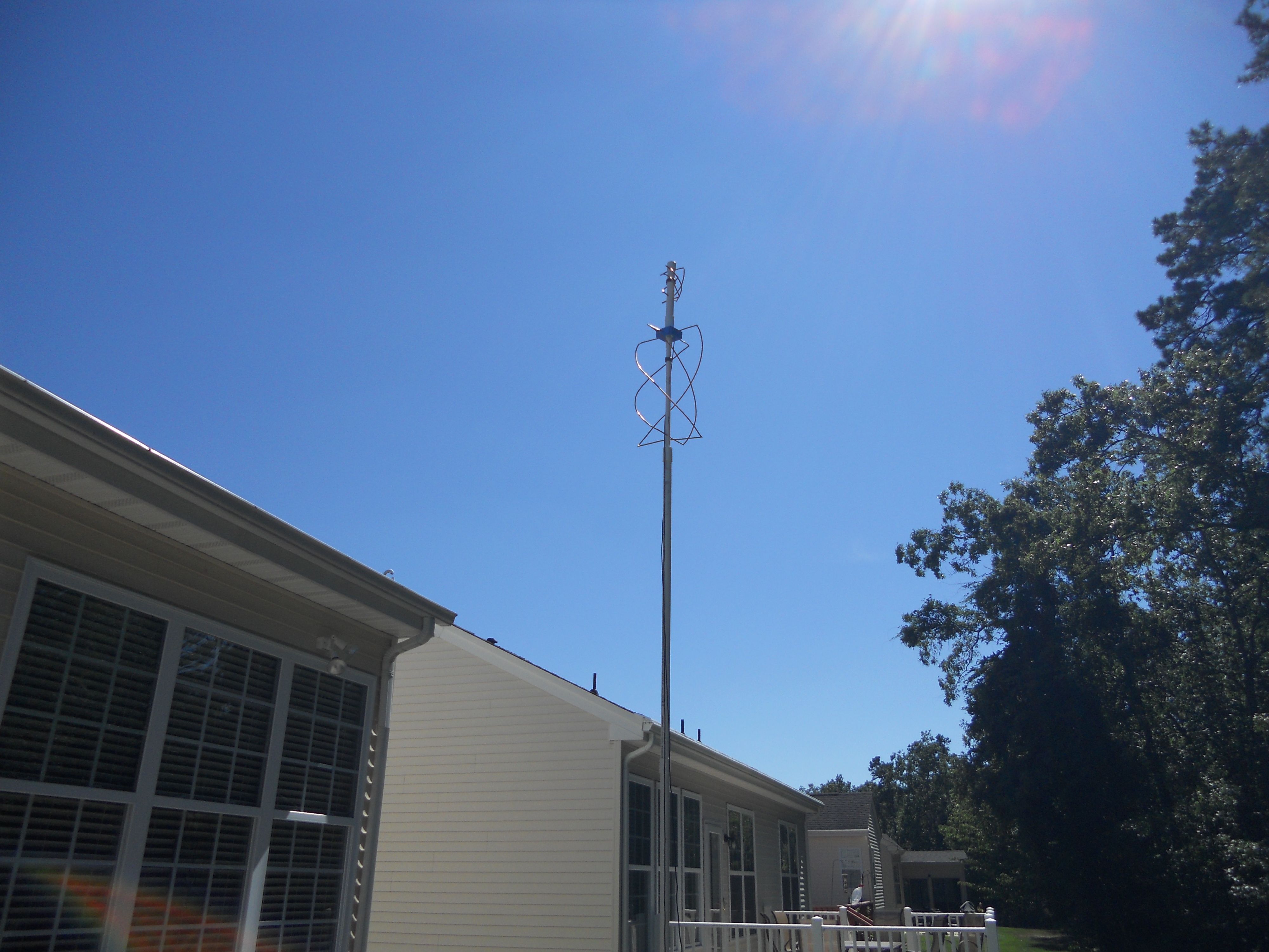

I built a quadrifilar helicoidal antenna just for NOAA satellite reception and I use it for 2 meters. The picture is the a 2 meter + NOAA reception antenna with a 440 section on top which I will try to make contacts via HAM Radio satellite, as soon as it gets a little warmer.

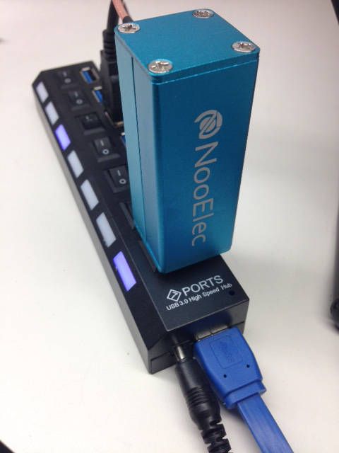

Nooelec enclosure looks real nice, well made and nice blue color. Great company.

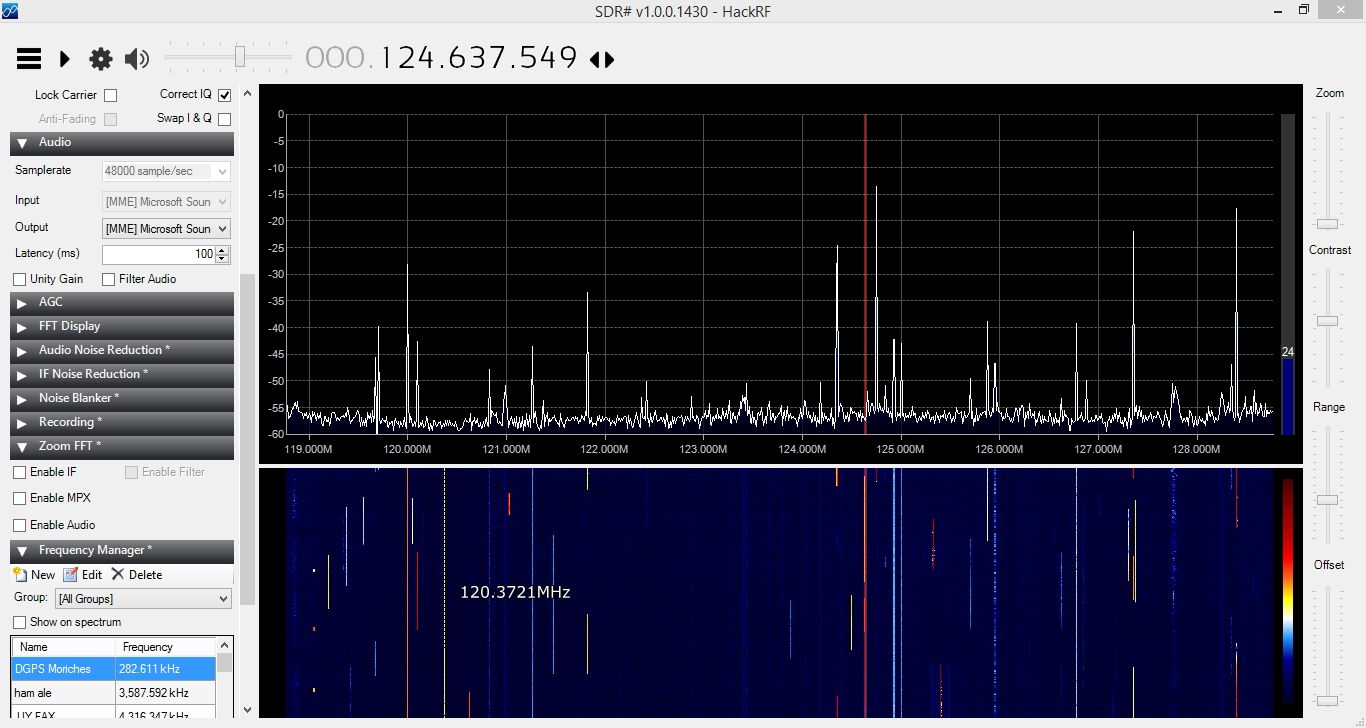

A Raine, most of the comms from pilots seem to be in the region of 118 - 136 MHz in the aero band. Attached is a screenshot of air comms this morning. Note that this is not the SDR dongle, it is the HackRF One, which shows a 9 MHz span. The HackRF One is like an SDR Dongle but on steroids. But you'll get the same reception using an SDR dongle. Use AM and crank up the RF gain to the max.
Maybe we have some pilots on the forum that can give us tips on listening?
