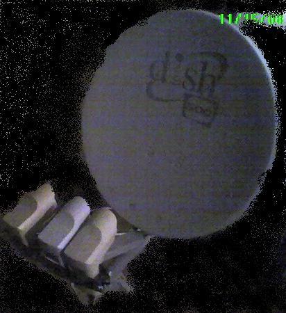

Home made 1k4 from dish 500 and 3 DP LNBFs
Home made 1k4 from dish 500 I-adapter and 3 DP LNBFs. Plus two metal bars and 3 bolts with nuts.
Were the signals harder to tune in than what a 1000 dish is at 110/119/129? How much harder?
Not that much - I'm using PSA-37D portable spectrum analyzer for tune.
The drawback of the homemade dish is spacing between LNBFs, so I wouldn't recommend it as permanent, just temporary solution.
It required additional tuning by sliding LNBF; that I-adapter is holding OK (counting that fact is a climate here is perfect without snow or wind ), but I would rather see native 1k4 cluster with own sturdy holder.
