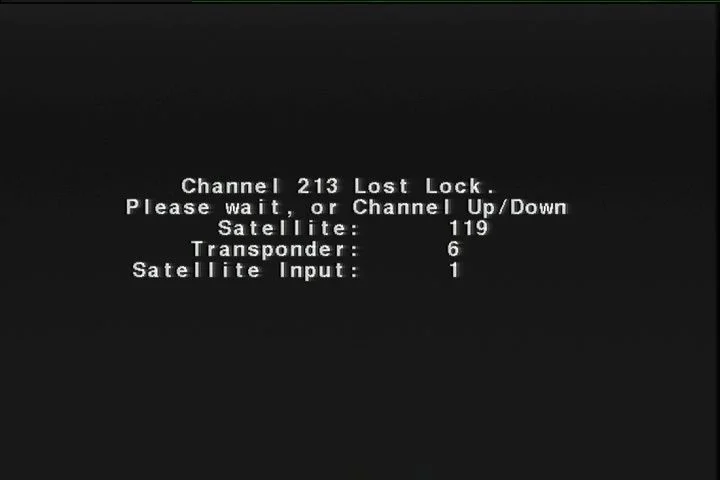

I keep getting the following error which can be seen in this pic. But now it works but then it gives me this screen again. If I switch to input 2 it works. It is snowing here but I dont think its that.

John here is the truly bizaare thing. It is only channels 131, 143, 174, 189, 205, 213, 214, 215, 226 that are affected. I looked on Lyngsat and noticed they are All on 119 TP6! On sat input 2 they all work. But sat input 1 works on all channels but them!

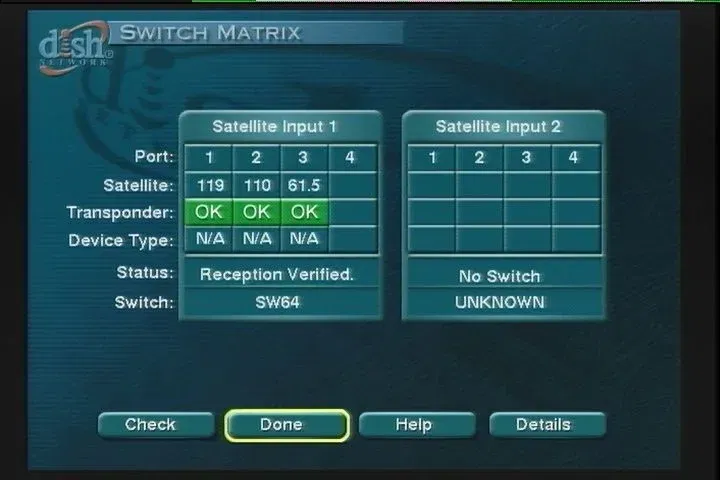

Here is a new picture. Now when I do a check switch iit finds the SW64 on input one but not 2!!!!! ARGH!!!!!!!!!

Hey, Sparker...
Allow me to break up this thread that evidently you're conducting all by yourself!!! Anyway, when this happened to me, I had an LNBF go bad, and it was easily fixed by a Dish repairman. You probably don't need a new box, just a new dual LNBF.
