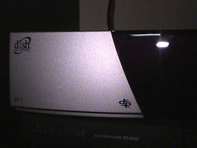

Can you take a picture of your 811 with the dishpro label so everyone can see?
Thanks

sure
bjohn said:
No, I'm not a dish csr :)
Thanks
Sure. Here you go
