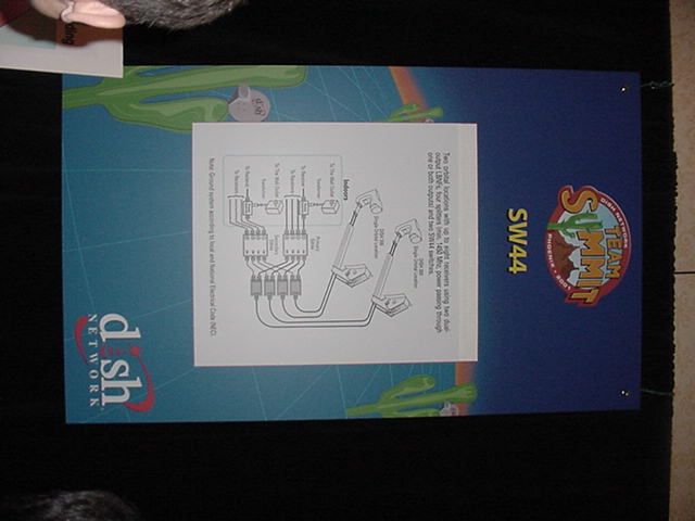

To stay legacy and add a 5th tuner you would have to add 2 SW44 switches in parallel using splitters (diagram). Something similar can be done with 2 SW64s but it's even more complicated with the feed loads that have to be added.
