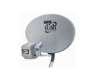

Your local market requires a SuperDish 105. I've attached a photo below so you can see what the dish will look like. You are NOT going to be able to use a DishProPlus (DPP) LNB with your 105 SD. You can use a DPP44 switch which all it would allow you to do with your SD system is to configure a 4th SAT feed from a separate single dish (ex. 61.5/148) into your setup. Using a DPP44 with the SD you will NOT be able to use single coax runs to dual tuners and use separators to split the signal into 2 feeds at the receivers. Your going to need 2 SAT feeds at those locations from your DP34 or DPP44 switch locations.
The difference between the DP34 (which will come with your 105 SD) and a DPP44 in your case, the name says it all. DP34 (3) in from the SAT (4) out to receivers. DPP44 (4) in from the SAT (4) out to receivers. Each of these switches can be cascaded out to a total of 3 switches giving you a grand total of 12 receiver tuner outputs.
If you have the luxury of wiring your house as it's being built, run 2 SAT IN coaxes and 1 SAT OUT at every possible TV location your going to have up into attic space to one central location so you'll always be able to get to them and configure your system any way you want in the future. With the use of your multi-switch/switches and grounding blocks or barrel connectors you'll be able to do what ever in the world you want to with your system. Just be sure and label each end of your coaxes so you'll know whats what. Coax is relatively cheap to install now before the fact compared to needing it after the fact.

cheezehead said:
I love the HD programming but the VOOM lineup doesn't sound like anything I would watch.
If thats the case don't ever bother with the expense of a DPP44 switch then your SuperDish 105 will come with (1) DP34 switch and by you only needing 4 receiver outputs to feed your (2) dual tuner 942's you will only need that (1) DP34.

Why would he need a DPP44 with his SuperDish? He wasn't needing a 4th SAT feed mixed in his system? The 105 FSS LNB is not going to let him utilize sending both feeds in one coax to feed a dual tuner.
kavula said:
ii). You will have one or two receivers
a. You need a SuperDish with a DPP Twin
I know for a fact that ain't gonna work. A DPP Twin isn't going to fit onto the 105 assembly. Here again, the 105 FSS LNB will not mix into the DPP Twin.
