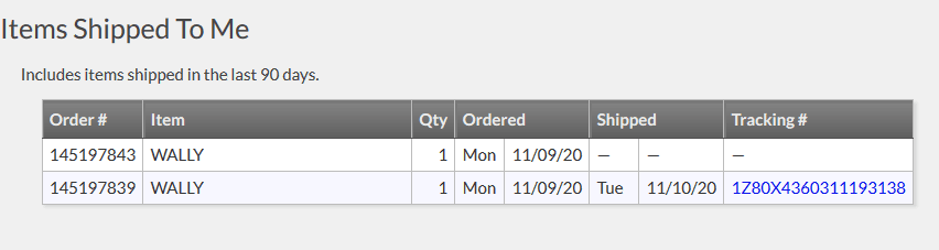

Well now this is getting frustrating. I ordered a pair of Wallys on the 9th. They were supposedly shipped on the 10th but when I go to Mydish page it does show two orders but only one has a ship date and tracking number. The one with the tracking number arrived Friday. Every time I call about it (3) they tell me the system shows it was shipped and I should be patient. However, they can't explain the lack of a tracking number. UPS was just here and no Wally again. This shouldn't be this difficult.
If the CSR tells you it shipped ask them to give you the tracking number verbally and see if they can.
  • Love
Reactions: pattykay
They don't have a tracking number for it.
