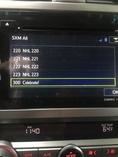

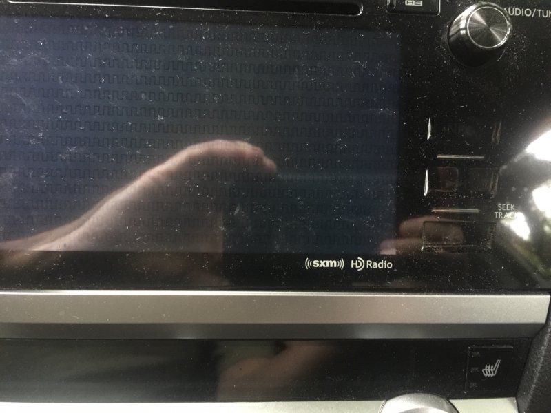

So- is this (((SXM))) the same moniker as SiriusXM? 2016 Outback.
I can tune in 300 Celebrate! so I guess it's XM? But it cuts in and out, and sometimes says No Signal. But I'm parked under a tree and a storm is approaching.
Actually sorry for it to be XM. AQ is just not so good. Harman Kardon.
